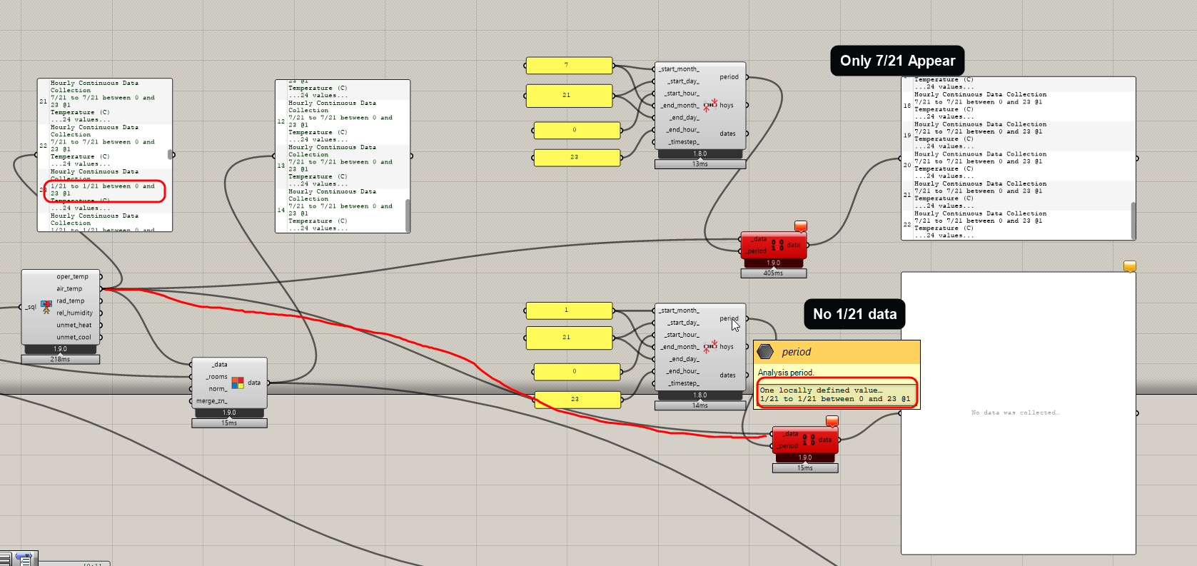

When trying to extract data from simulations where I used the WinterDesignDay and SummerDesignDay is very hard to differenciate between those two EnvironmentPeriodIndex, and even the Apply Period doesn’t work (It either picks one of them, and the data is not consistent to what I see in DesignBuilder Results Viewer).
For example, I have a simulation with just those to Periods (No RunPeriod), When I extract data, I clearly see there’s two days, 1/21 and 7/21.
But when I use the component HB Filter Room Result, then the WinterDesignDay data disapears, and it’s not possible to recover it using an applied period, even from the HB Read Room result which clearly does have that data.
On the other hand, if I do a custom result through the SQL, the results don’t match what I have in the .eso file. I filtered using various Match Text and Dispatch and I reached the room I want to analyse in both periods, but through this method it’s not the correct information.

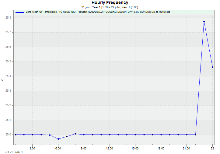

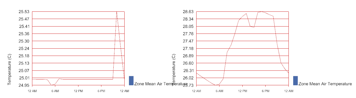

Left is using HB Read Room Comfort Result for the same time period and same zone as the right, where I do use the read custom result for the same data. This is what I see on the .eso file.
Am I missing something? Is there a way to properly select those? As in RunPeriod, and the DesignDays.
