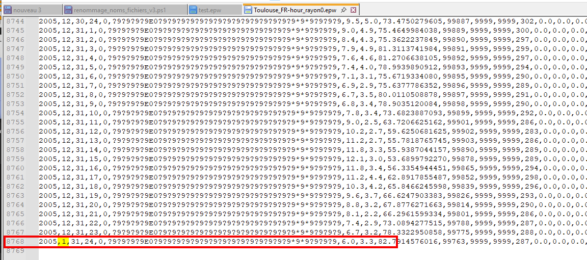

Hi @chris,
I think that the correction is not working or has not been included in the new version of Ladybug Tools.
I get this error when I try to create a new EPW file with the “DF Create EPW” component.
Thanks, @mchabasset ,
It was a bug that only affected the month field of the last item in the EPW. I fixed it here:
The fix should be available via the LB Versioner in an hour or so.
