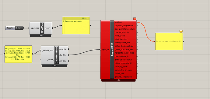

Hello, do you have any screenshots?
yes, here it is :
I tried reinstaling the tool and now it shows : 1. Solution exception:C:\Users\HACKER707\AppData\Roaming\ladybug_tools\weather\MAR_FK_Fes.601400_TMYx\MAR_FK_Fes.601400_TMYx.stat is not an .epw file.
It does not possess the .epw file extension.

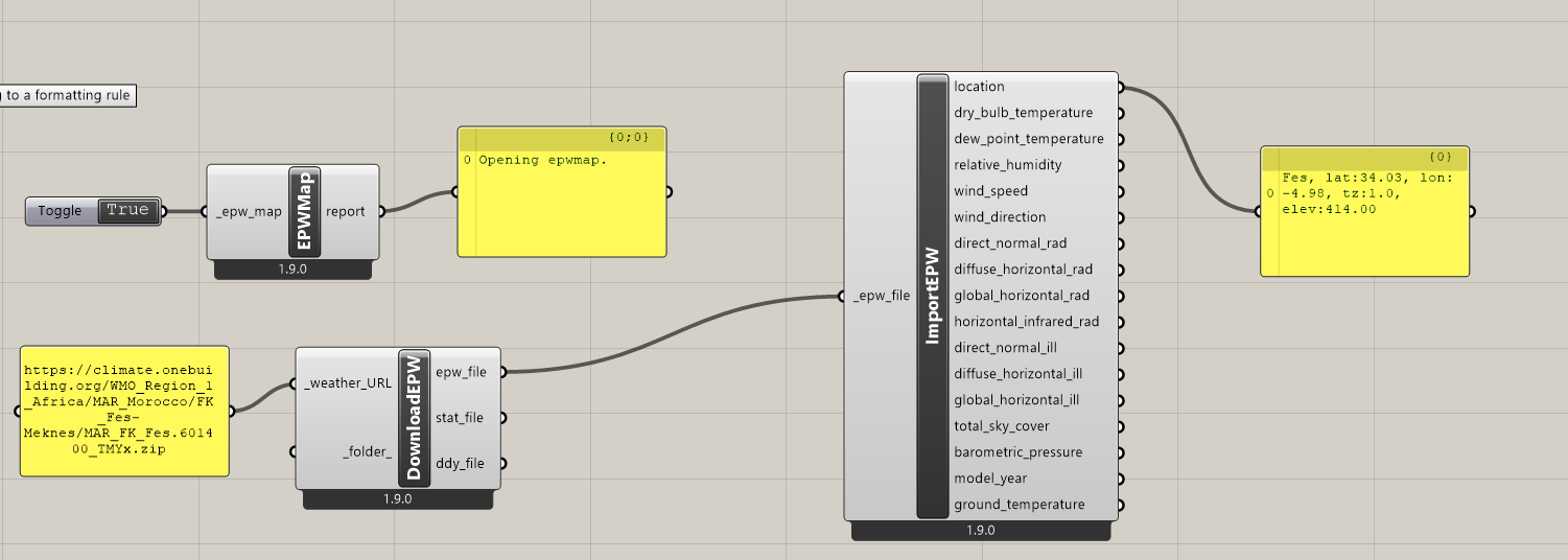

Try connecting the epw_file output to the _epw_file of the LB Import EPW. In your screenshot you connected the stat_file.
Edit: If you want to read the stat_file you need to use the LB Import STAT component instead.
