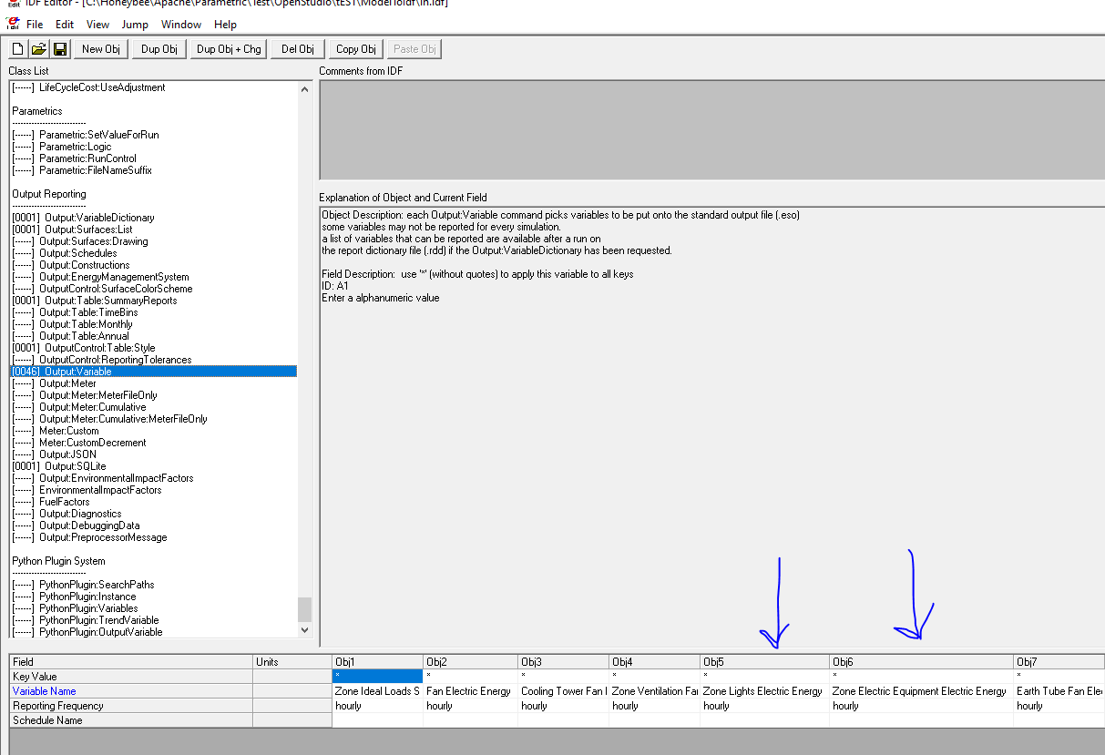

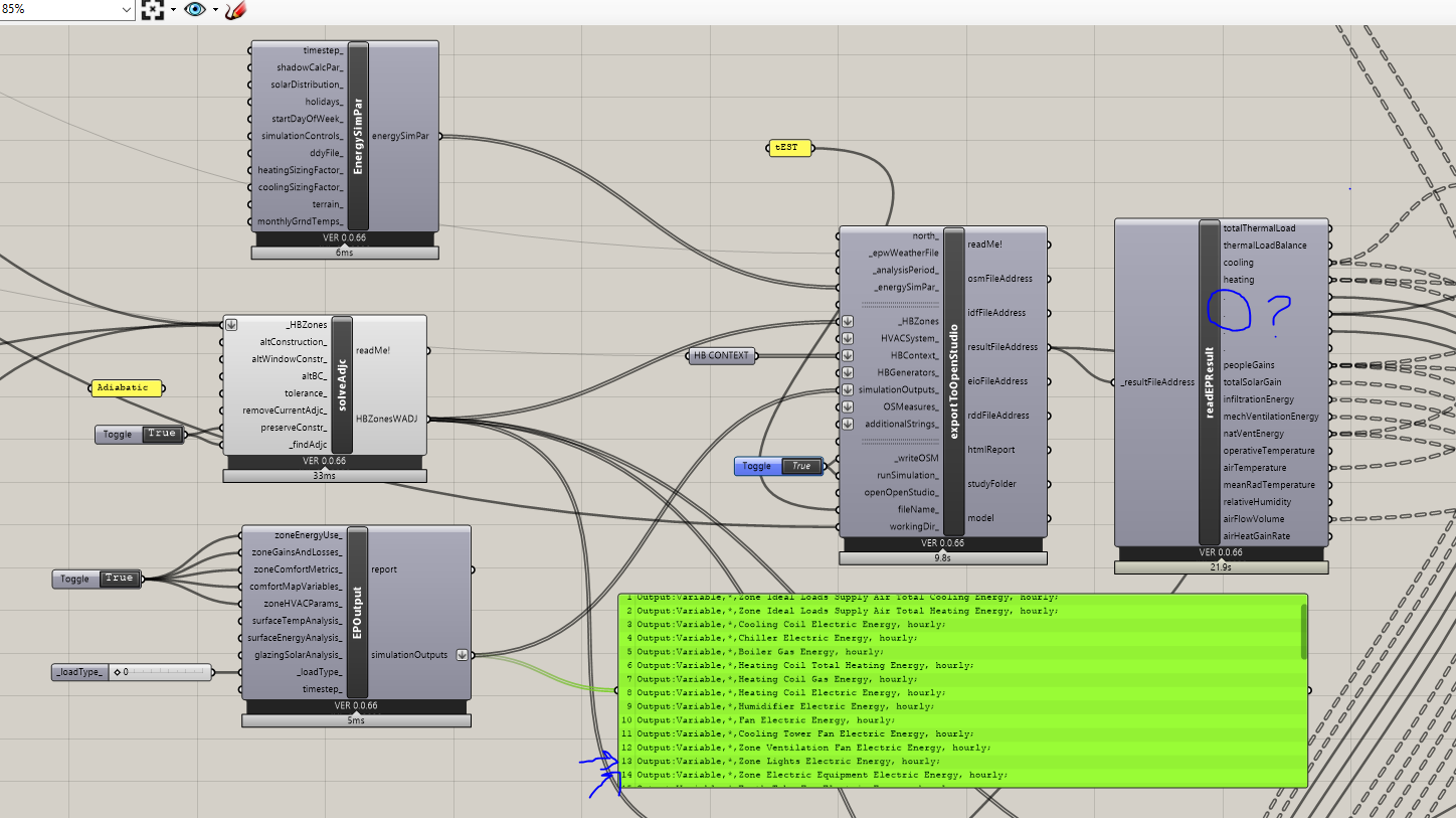

I am running some tests in a residential unit. The tests were running smoothly and suddenly the electric and lighting outputs disappeared. When this happened there was no change done to any input related to them or the outputs set up. Since then I haven’t been able to get those outputs back.
They are in the EP Output and in the IDF, but they do not appear in the CSV with the results. The simulation is affected by them, as I can see in the temperatures profile how the equipment kicks in (the lighting is very efficient, so I couldn’t say for sure).

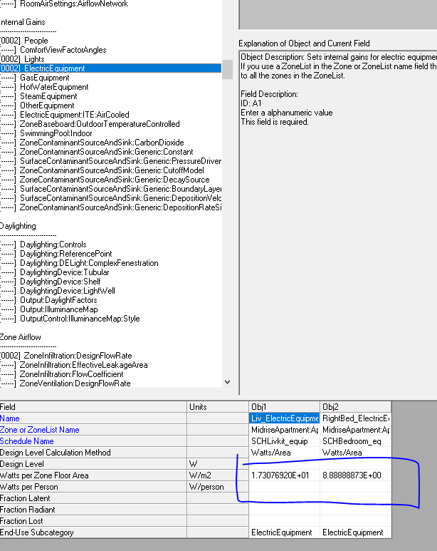

From the IDF:
Any idea of what can be happening? Any help will be appreciated.
