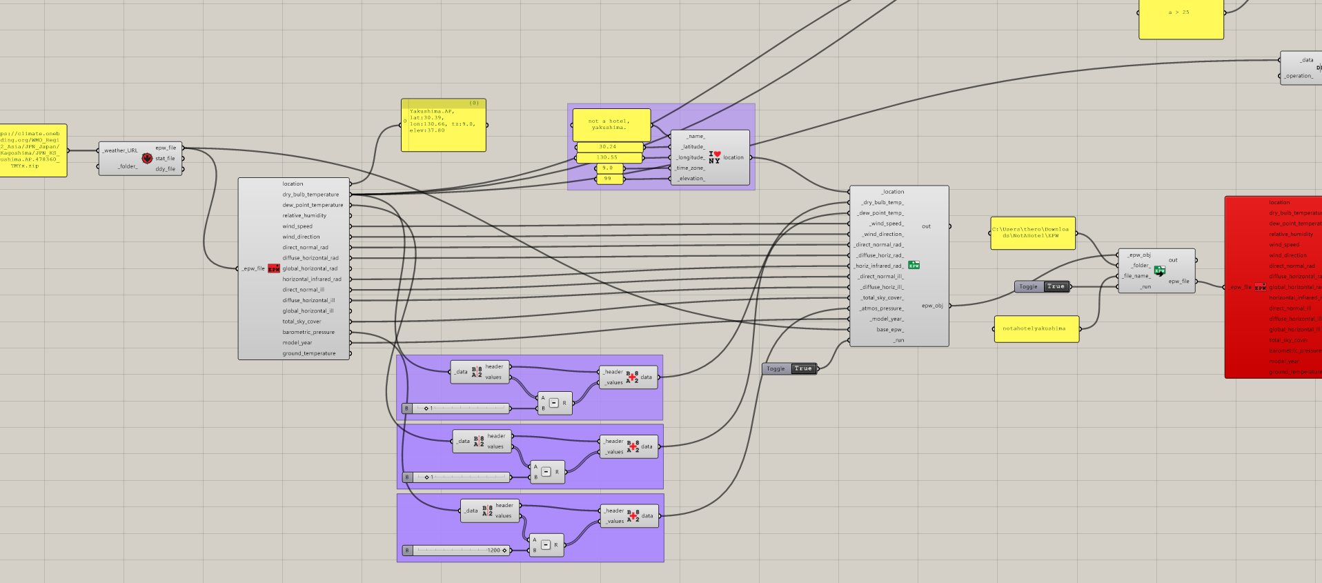

Error 1. Solution exception:invalid literal for float(): None
Hi @rohithvinod I believe you need the file extension to go directly to the epw file: xxx\xxx\file_that_is_epw.epw not a directory path to the folder itself: I believe the path in this case should go directly to the epw file.
Hopefully that works and is helpful
Hi, Trevor.
Indeed it was helpful and works perfect. Thank you so much for your valuable insight.
