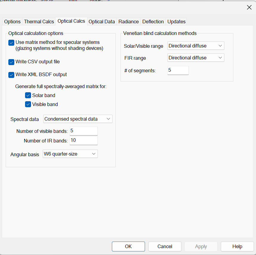

I’m using Window7.8 for my simulations and applied the following settings.
However, when I connect the output file to Honeybee Plus for 5-Phase simulation, I get this error:
Solution exception: Failed to load the results from an empty file: c:\ladybug\untitled\gridbased_fivephase\result/GlassSouth…default.ill
Double check inputs and outputs and make sure everything is run correctly.
Has anyone encountered this issue or can suggest a fix? Thanks!

You cannot have a whitespace in the xml file since Radiance will fail. Try to rename the file to Mona.xml.
