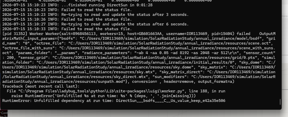

I recently upgraded to Ladybug tools version 1.10.0 and also upgraded my radiance to the 5.4 (2023-11-05) version as mentioned in the compatibility matrix. While installing I had an error regarding the PATH regardless of the options I selected during the installation wizard. The application installed successfully in the end and the simulation within grasshopper would start without any error but it would crash down the line. I was wondering if anyone else has the same issues or if anyone has any idea what it could be the cause of it.
I attached both the terminal instance it would get stuck and the message that comes out from the recipe.
