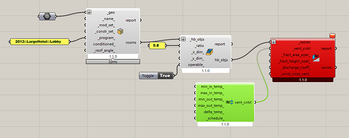

Skylight can’t be operable?
The error of the component " HB Window Opening" is 1. Solution exception:Attempted to divide by zero.
I also had this error. I don’t know why but you have to have the skylight modelled at a slight angle to the horizontal to get HB Window Opening to work.
Cheers,
@Eric Thank you so much!! :+1:
