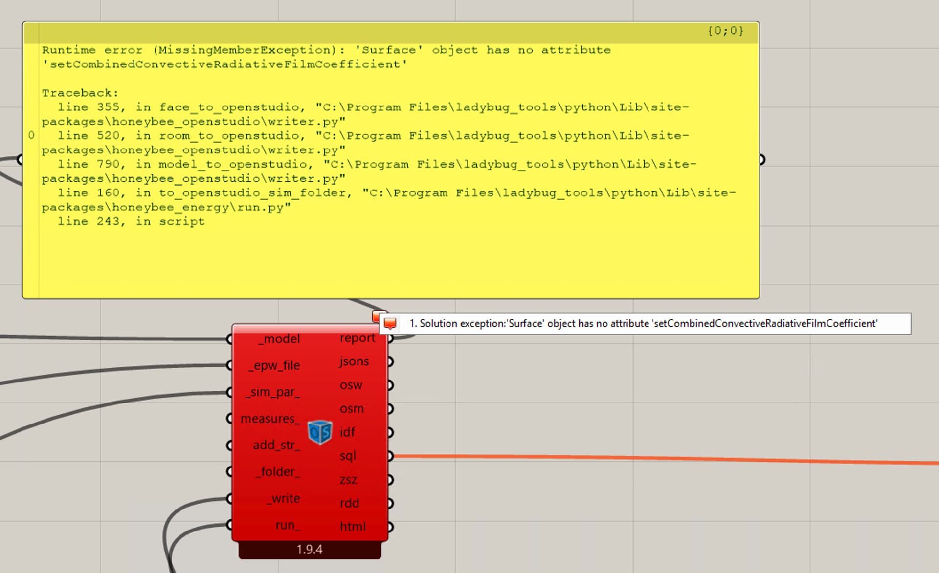

I’m trying to assign the “HB Other Side Temperature” to a boundary condition of a Face. If I then want to run the simulation i get the following error from the “HB Model to OSM”.
  1. Solution exception:‘Surface’ object has no attribute ‘setCombinedConvectiveRadiativeFilmCoefficient’
(To reproduce the error you can use the shoe_box_energy_model from the example files and just add the “HB Other Side Temperature” to one of the bc inputs of the “HB Face”)

This seems like a bug (maybe resulting from changes to the names of methods in the latest version of OpenStudio SDK). Give me a little bit of time, and I should be able to push a fix that you can get with the LB Versioner component.

I was able to recreate the error and I just pushed a fix for it:
You can get the fix on your end now by running the LB Versioner component. And the fix will be in the next release of the pollination installers.
