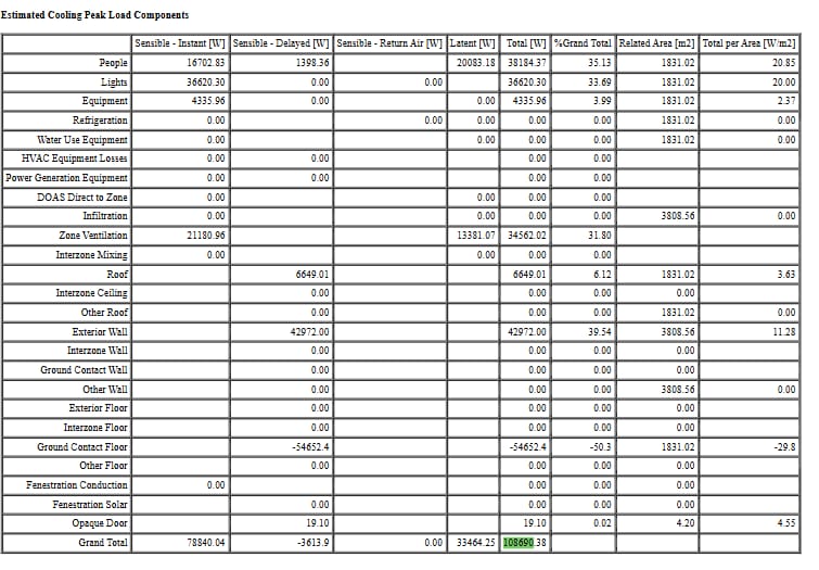

Estimated cooling peak has higher values than those presented in the peak sensible loads
Normally, the load shown in the estimated cooling peak loads component has higher values than those presented in the peak sensible loads. In my case, the loads shown in the HVAC sizing are higher than the sum of the estimated ones. Where can the breakdown of the calculated loads be found?

Peak Sensible Load with Sizing Factor [W]: 219137.12
Difference Due to Sizing Factor [W]: 28583.10
Peak Sensible Load [W]: 190554.02
Estimated Instant + Delayed Sensible Load [W]: 75226.13
Difference Between Peak and Estimated Sensible Load [W]: 115327.89

The sizing factor is applied to obtain the difference Difference Due to Sizing Factor [W]: 28583.10, but when we compare it with Estimated Instant + Delayed Sensible Load [W]: 75226.13, the value Difference Between Peak and Estimated Sensible Load [W]: 115327.89 is much greater than 1.15.
You have pasted a lot of numbers here, @allans.cypriano , and I’m actually not sure which two you are comparing. Is there a number output from a Grasshopper component that you have not posted here yet?
If so, do you have a sample .gh file that you can compare against the HTML table you pasted above?
