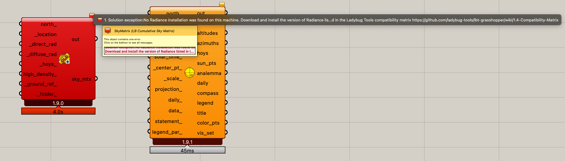

Exception: No Radiance installation was found on this machine
I’m having trouble resolving this issue. All my Ladybug components work fine except for the Sky Matrix component, which has an “OLD” label.
I’m using a Mac with the 1.9 version of Ladybug. I uninstalled/installed Ladybug but this component is still not working. Can anyone help please?
Did you use the pollination cloud installer?
That usually fixes things like this.
