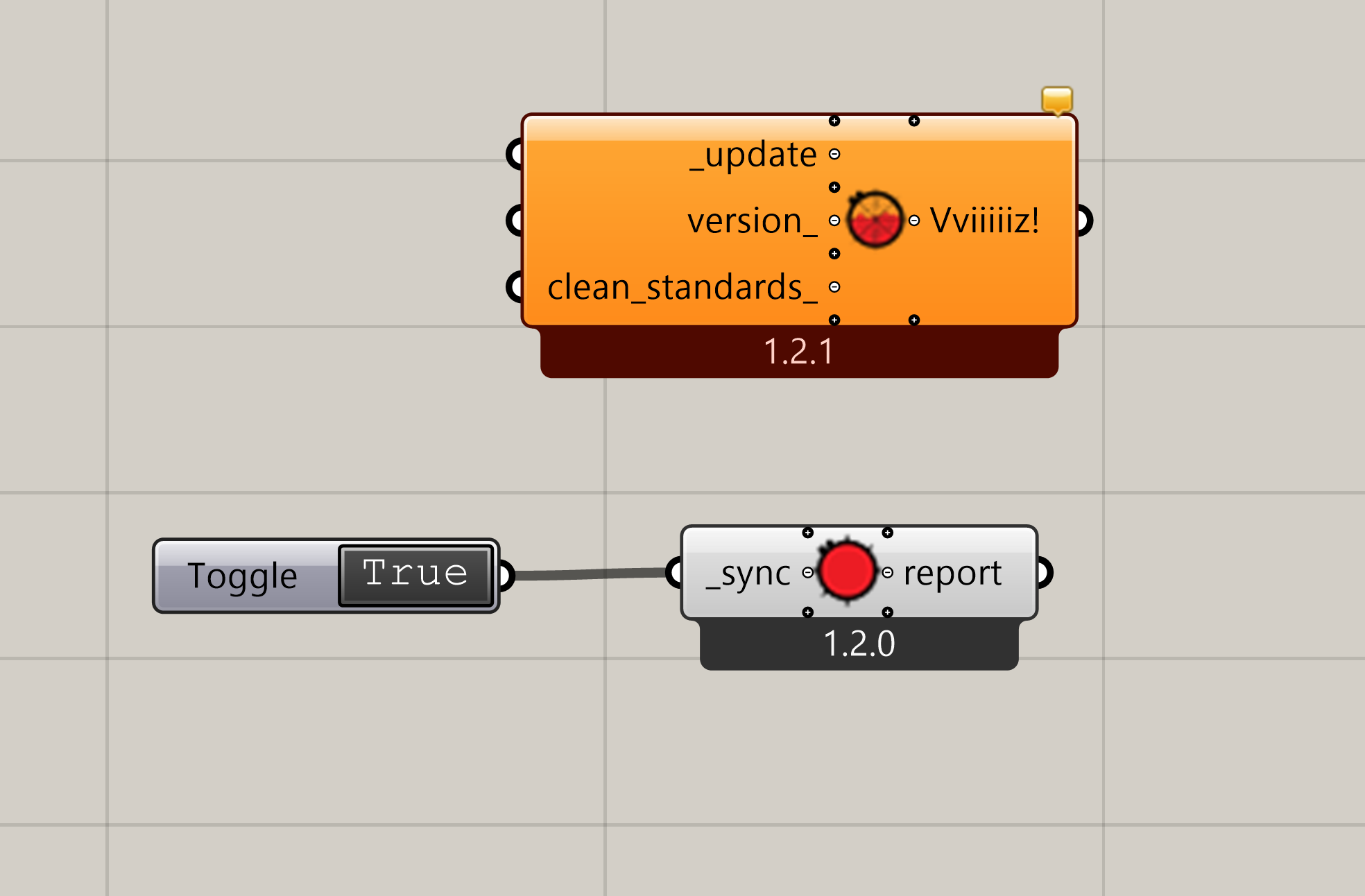

I would suggest you to update to development version and sync the gh file. This is not an ideal solution but should work.
@Elli.akr
I agree with @Teja5zz’s suggestion, and if that doesn’t work try the last stable version “1.2.0” (if you’re not already using it).

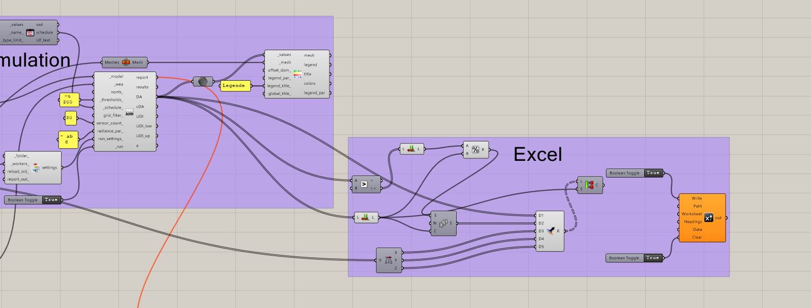

My task is to change three parameters and find out from which angle, which length and how many rods the model gives the best results. The evaluation of each simulation should be listed in an Excel. However, this does not work. The simulation works, the results are just not transferred to an Excel. I can’t find the error. I got the error message when I connected the Excel components.

I have now shared a screenshot again, what is the best way to proceed?

It’s hard to help because your posts aren’t very clear. What exactly did you try? Also your latest screenshot seems to show the error message has dissappeared from the HB component? So did you manage to find a way to resolve that, and now you have a new bug with the Excel component?

Okay, I’ll try to explain it a bit more broken down.
I have created a daylight simulation and now I am supposed to run it. The daylight simulation gives me values for my settings to be determined. So the simulation works fine.
These data are to be displayed in an Excel table. The specifications for my excel sheet were given to me and I added the components to my simulation at the end.
Then I downloaded LunchBox, because TT Toolbox does not work.
I use the Excel Write component.
I open Excel and my file where it will be saved is called “Folder1”.
I set the toogle to True, but nothing is transferred to the excel sheet.
  1. a new excel file opens permanently. It’s like a bug that opens and closes the window all the time.
  2. no data is written to the Excel worksheet.
I doubt it’s the simulation, since it gives me different data for different states in Rhino.
I have Excel installed and logged in there as well. It can’t be due to a user account either, so to speak.
I did the installation for LunchBox through Food4Rhino and that works fine.
When installing TT Toolbox everything seems to run despite installation steps.
I really hope that I could clarify the problem in more detail.

From my amateur perspective (I’ve never used Lunchbox tools and too lazy to do it now and test my assumptions) I did notice some potential errors in your script.
  • Improper Headings input: I think when you input a tree of data to the Data input, the Headings should be a list of values corresponding to each branch. Right now you only have one heading. Did the excel file writer for your sensor coordinates (bottom-most component in image below) successfully write to your Excel sheet? That’s what the message seems to imply, and would validate my suspicion since you have one “branch” of data and one heading in that case.
  • Path input isn’t absolute. Have you tried using your full absolute path, i.e “C:\Users\Me\Study\da_results”. Also make sure you don’t have any exotic characters in your path like punctuation, spaces or accents.

  1. none of the sensor coordinates were transferred to an excel sheet.
  2. I change the path and the worksheet. In path i use: C:\Users\Svenja\Desktop\Elli\Excel but in the order isn’t a file. And in worksheet the Mappe1. It’s the name of the excelmap. Is it possible to have more over one heading?
If i did step 2, i have another error:
"System.NullReferenceException: Der Objektverweis wurde nicht auf eine Objektinstanz festgelegt bei LunchBox.WF_ExcelWriteNew.SolveInstance (IGH_DataAccess DA)
Solve this problem first before trying to debug the more complicated case.
Make sure to set up a separate GH file to test just the Excel writing workflow. If Lunchbox provides a sample file or even a screenshot showing a working example, use that. Once you’ve solved that, iterate complexity until you can get the Honeybee DA results working.
