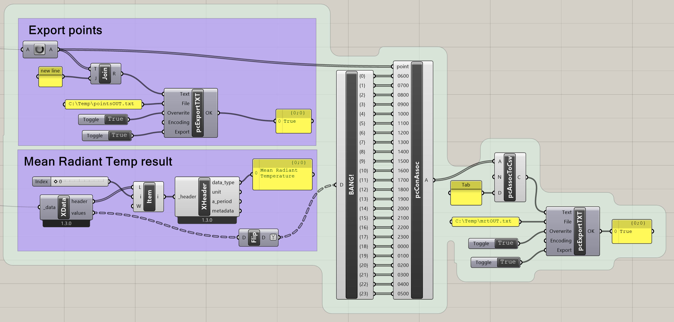

What I have landed on now is using Pancake to construct an associative array and then saving that to csv. I am curious to know what other solutions there are. Ultimately it would be awesome to interoperate with geojson data sources and I imagine that’s doable.

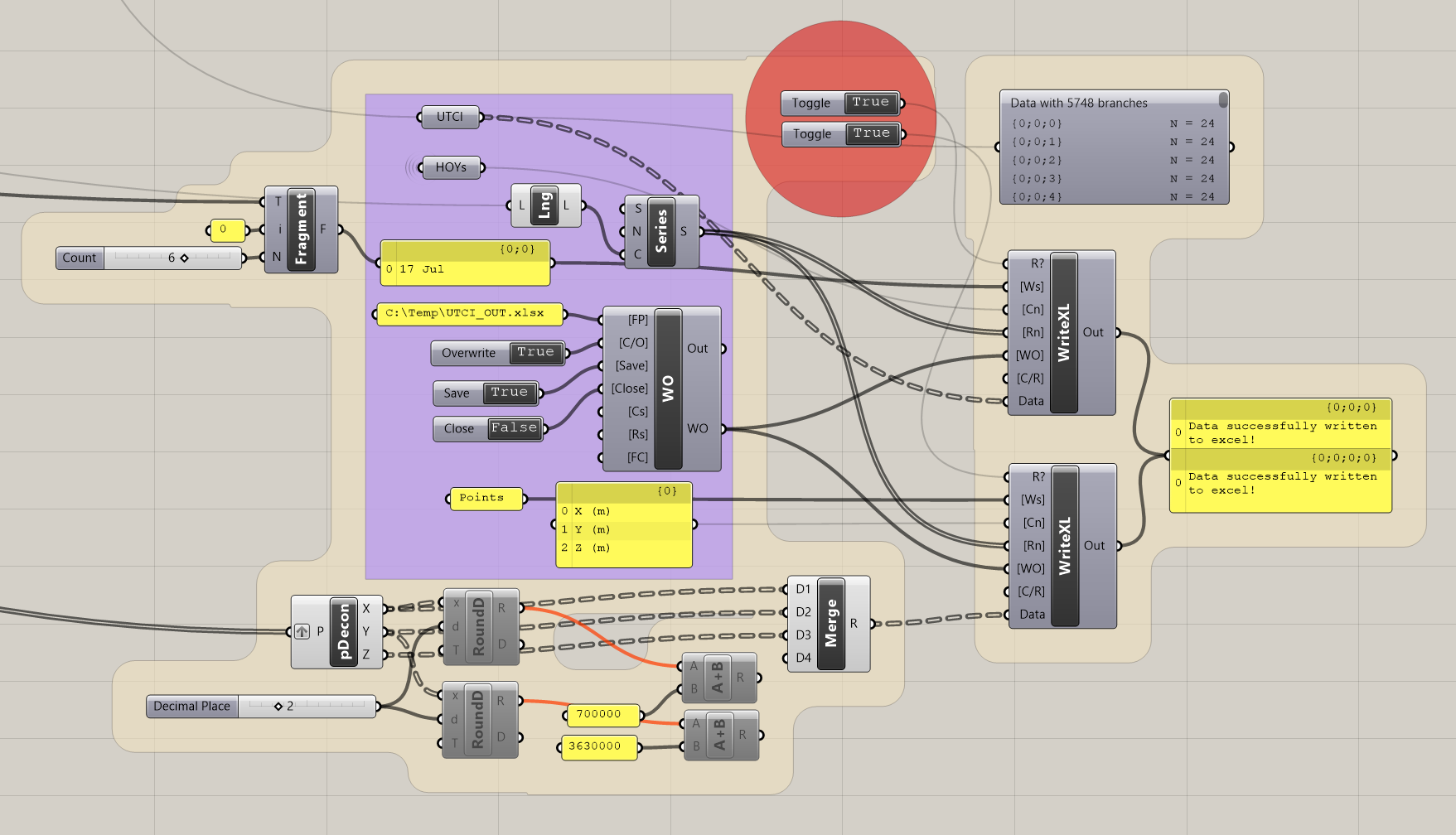

I think that the ‘to excel’ components in TT Toolboxwould allow for the writing of branches to columns/rows: that may be a bit helpful?
elif:
there should be a way to take the datatree branches and write em out to csv without BANG! and the compo to the left of it.
LMK if you find your endgame else would be hap to spend an hour trying to figure a streamlined means; when has time!
Thanks @TrevorFedyna
Here is a definition cluster with TT Toolbox, which works fine.
It’s great that it will work no matter how many branches, and it’s nice to put multiple datastreams in one file. A couple of complaints about this method though, one being that this plugin hasn’t been updated in 4 years and I hope it will work with future versions of R/gh. It also means another step to convert to csv later for use in other platforms.
Another problem is visible in the disabled components – if I add the geographic offset then value ends up being rounded to the hundreds or something which is obviously not doable. I don’t know if it’s a grasshopper problem, TT, or excel – excel has a way of formatting things losing significant digits. It would be nice if I could just dump a float to an ascii decimal.

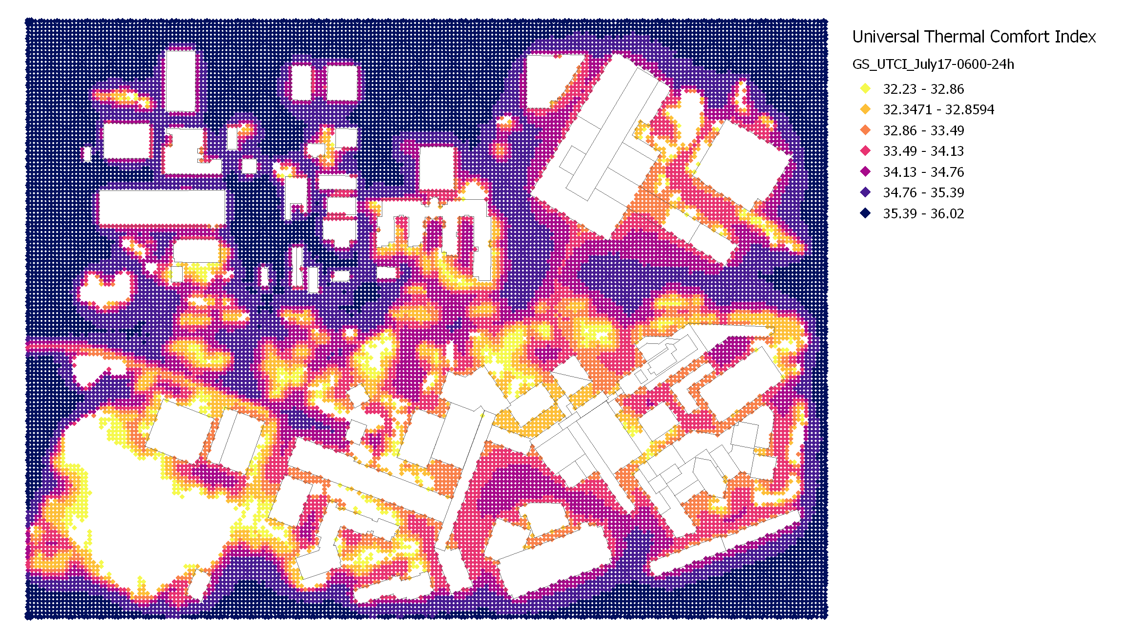

Update on exporting ladybug results in real coordinates:
Now I’m using DeCodingSpaces to export geojson which works pretty well.
The hoy list is flat so that each point will pick up every single hoy as an attribute key – the data tree then has x values per point/branch which correspond to the number of hoy’s.
Works!
From QGIS, symbology for a selected hoy.
Nice!!!
