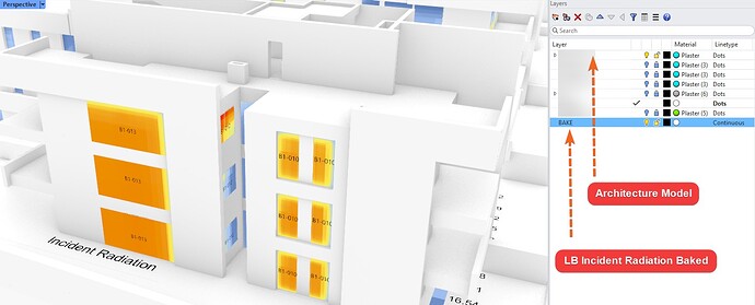

I’m doing some radiation analysis for an architectural firm; they really like how Ladybug does all the visualization! They are asking me for a series of images so they can take some architectural decisions, but the geometry is complicated, so I’ve thought I’d share a standard 3D model so they can use any online tool, SketchUp or Blender.
I’ve tried .obj, .dae and even the .3dm, all with export textures option, and having the color mapping from LB Incident Radiation (For example) baked into a Rhino Layer, but still I can’t make it work, it doesn’t have any textures whatsover.

Hi @adrisonet,
I’m not sure why they don’t get exported from Rhino, but if you know how to code, it is possible to export the results into a single HTML file. See here:
