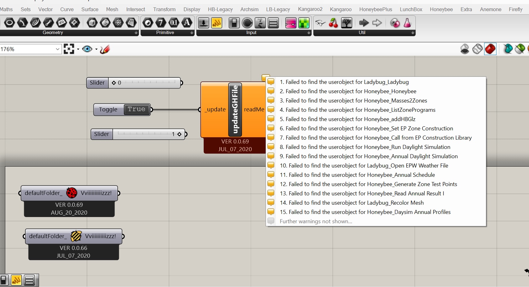

I don’t know why my file update doesn’t work correctly. it has a lot of errors of Failed to find the userobject for…
it doesn’t work with boolean toggle or 0/1

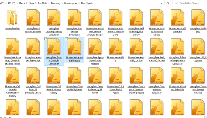

I suspect the ghuser files are at the wrong location on your computer.
thank you for your reply, could you plz tell me how can i check it?
Those files are supposed to be located at a location like this:
C:\Users\YOUR_USER_NAME\AppData\Roaming\Grasshopper\UserObjects
From the image above i see 0.0.69 for LB and 0.0.66 for HB …
yes. I have deleted all of my files and components from my computer in older version. then install this version. now i have alot of errors and update_GHFile don’t work.
