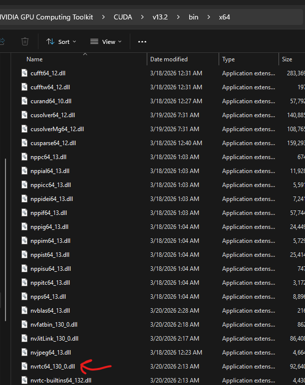

The DLLs are clearly here:
It seems though that the component / script cannot find it, or is looking in the wrong place, or is looking for the wrong version of CUDA.

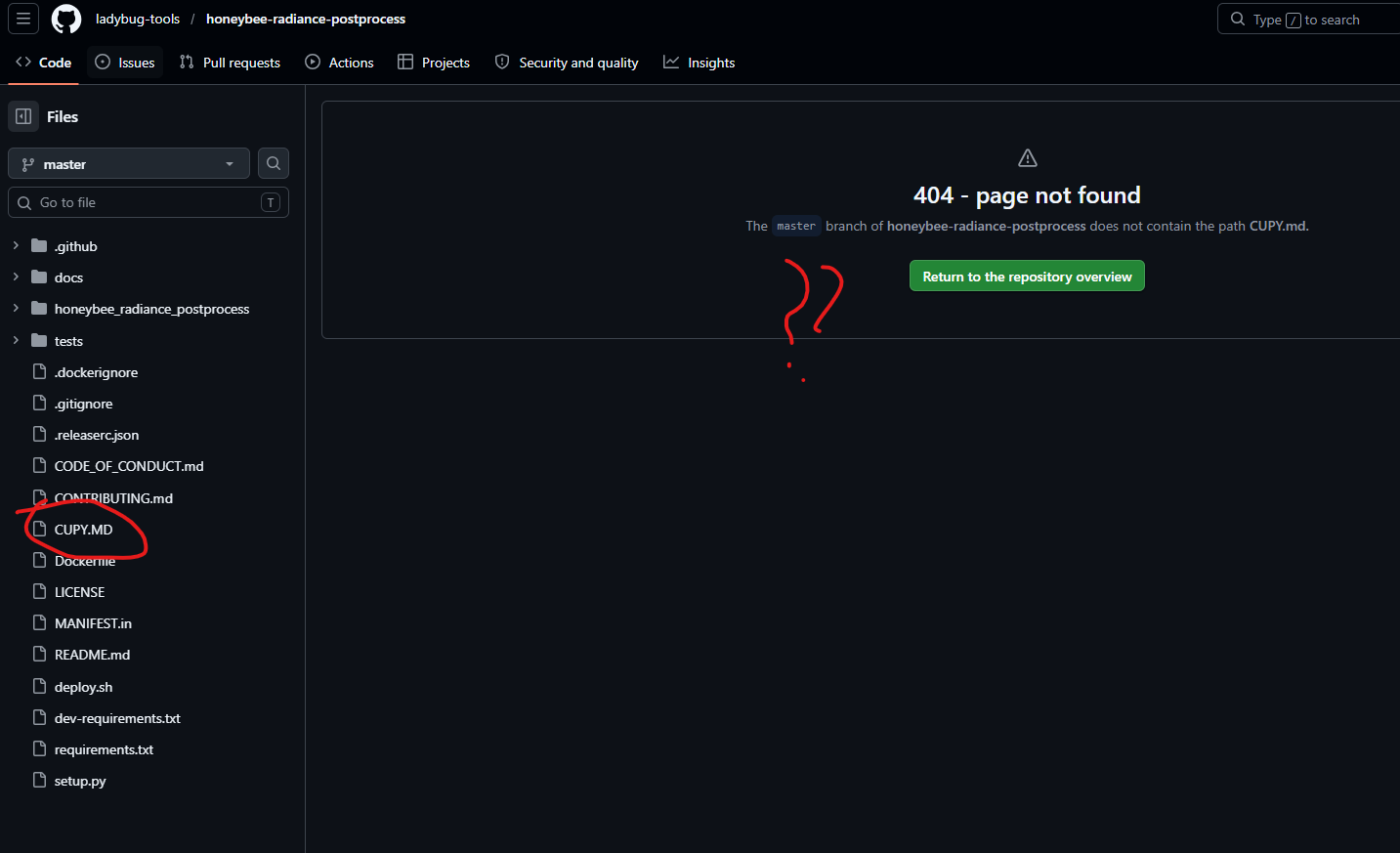

p.s. it seems like the link you have in the running log of HB UTCI map when it runs pointing to the CUDA.md page on github has been moved, it gives a “404 not found”, I found it manually looking in the directory of the github:

nvrtc64_120_0.dll in the error message suggests that your honeybee-radiance-postprocess is using cupy-cuda12x, which is the version that ships with the library. Because of this you need CUDA Toolkit 12.x.x – here is the latest version.
You can run it with CUDA Toolkit 13.x.x, but then you need to install cupy-cuda13x in the Python environment used by honeybee-radiance-postprocess – in LBT that would be this path by default: C:\Program Files\ladybug_tools\python\Lib\site-packages.

Thank you. I will fix this.

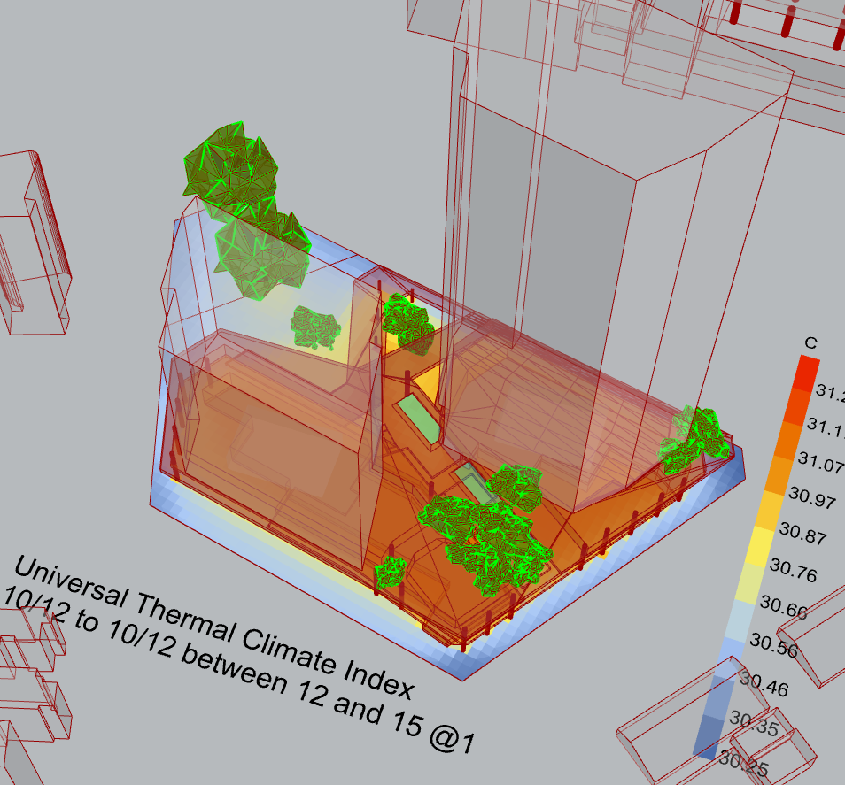

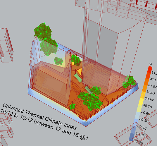

As for the speed, here is a screenshot of the model:
The sensors are 3m resolution, 2,000 sensors total. 4hr period of simulation over one day.
Are there settings or ways to limit how much HB simulates on the e+ side to speed up the simulation?
As far as inputs go its :
1 soil zone brep
1 asphalt zone brep
1 analysis sfc
46 breps representing the two towers / podium / roof
31 breps representing the context buildings
18 meshes representing the trees
This simulation took from 12:16 - 12:53 so 37 minutes.

If there are any Honeybee Rooms in your model here for UTCI sim, then running for just a 4-hour period is a waste of time. EnergyPlus needs to warm up by simulating the first day 5-6 times usually. So if you are running the UTCI period for anything less than a week, you might was well run it for a week since it’s going to be more or less the same runtime.
Alternatively, if you just set up your Honeybee Model without any rooms, you’ll find that the UTCI recipe runs a lot faster fi you only do 4 hours since, then it is only a Radiance simulation without using E+ to compute surface temperatures. And Radiance doesn’t have a big warmup time the way E+ does.

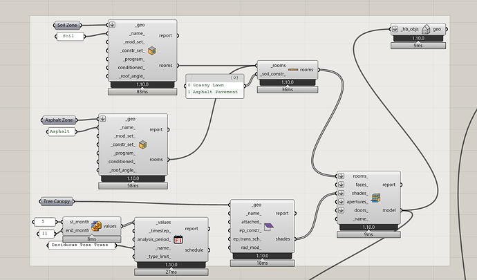

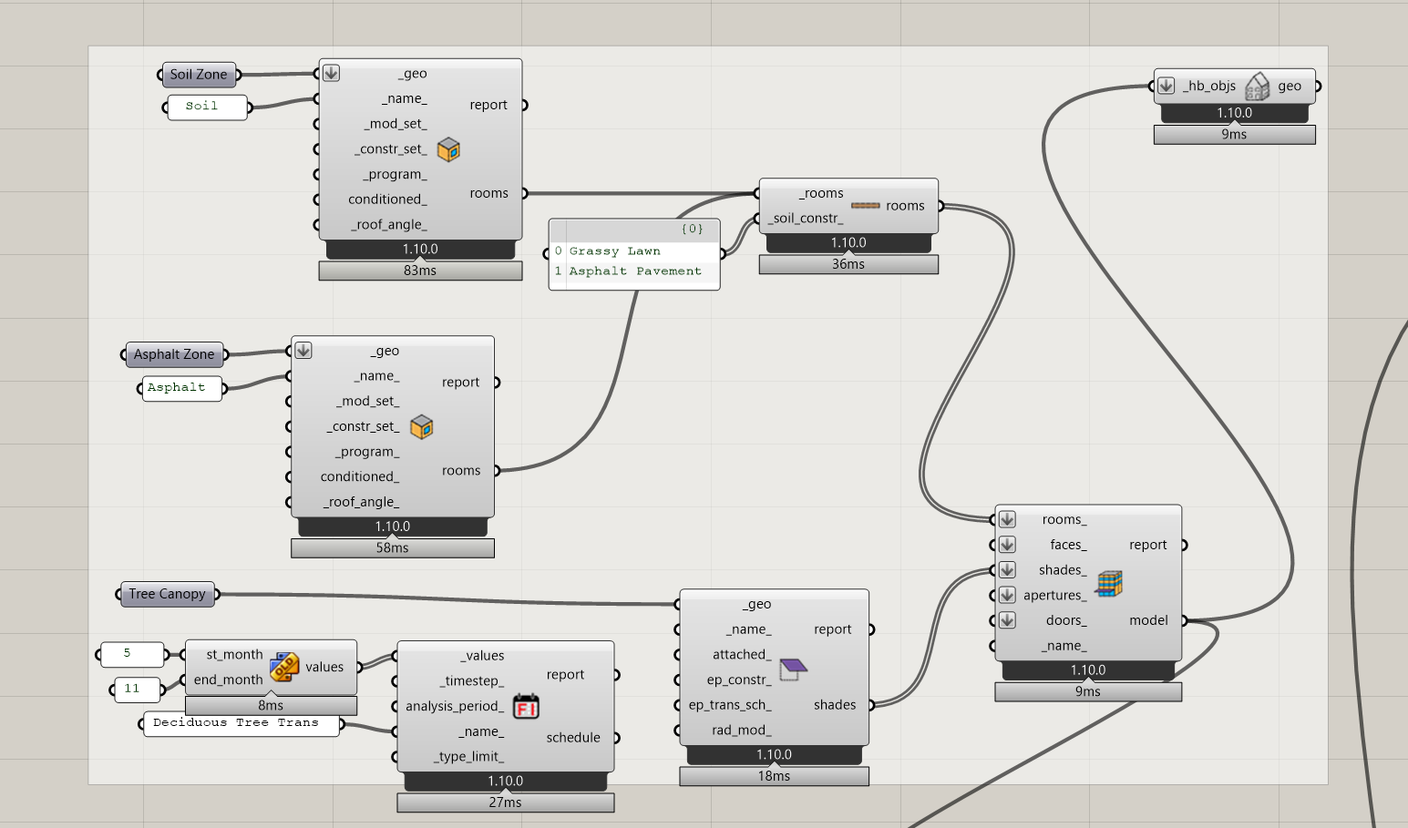

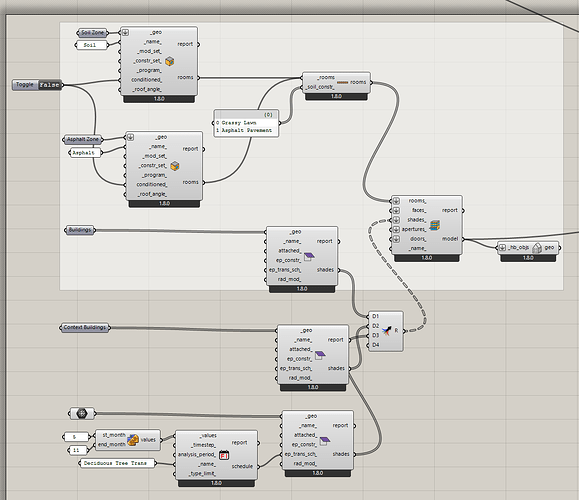

@Chris, clearly I do not understand well enough then how to setup the script with HB, since I have never used it before really.
I took the recipe in the LB recipe folder on GH, and just applied my own geometry.
A BREP with ~0.1m thickness (since it needs to be closed brep) for soil
A BREP with 0.1m thickness for Asphalt
Ignore “Tree Canopy”, inside that are all my context building shades.
Are you saying to skip the rooms all together? then where do I put the different surface zones into?
