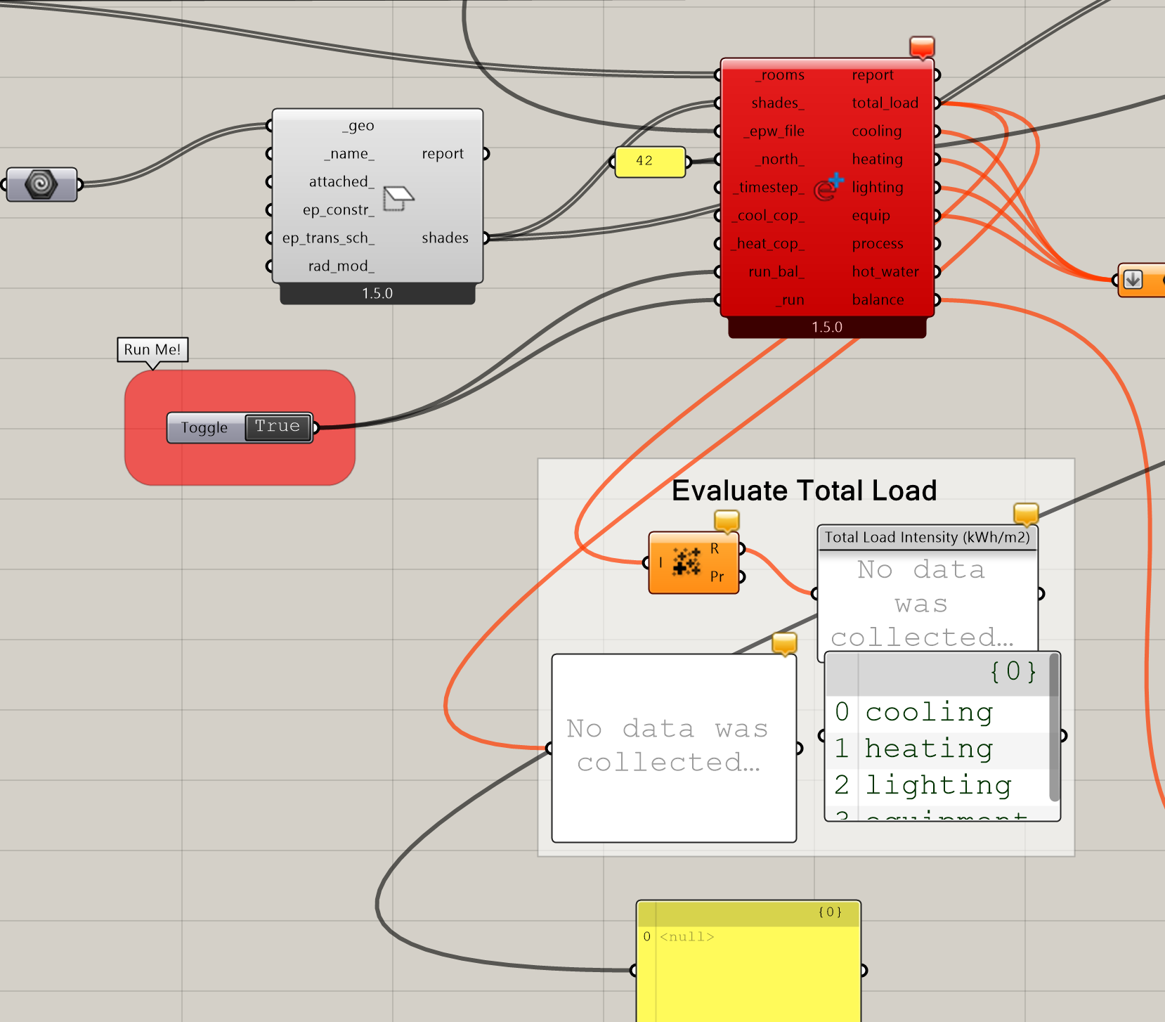

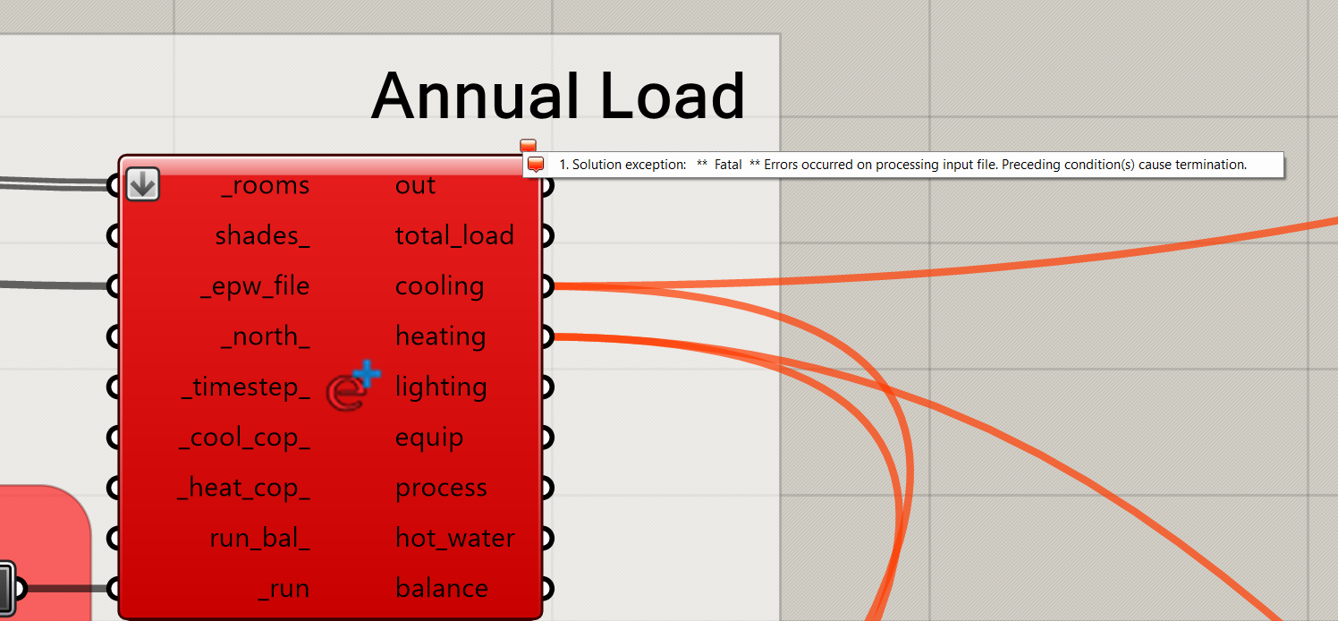

I’m trying to simulate various U values in windows in different facades, but it doesn’t run and shows fatal error even as the components are fine.
4.gh (212.6 KB)

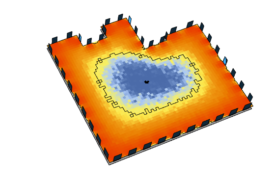

It stopped simulating daylight though (even though it’s exactly the same as before) shows absolute 0 or 1 in daylight simulation. How do I re-route it to work?

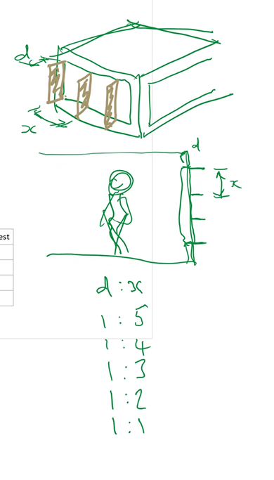

Also, I’d like to add shades to every direction (with something like this as ratios)

Thank you so much! I also need to examine the shades on different facades and their impact on direct solar hours. How can I set that up on different facades and compute the hours?
The shades in your sketch you can just make by extruding the edges of the window. Just plain grasshopper.

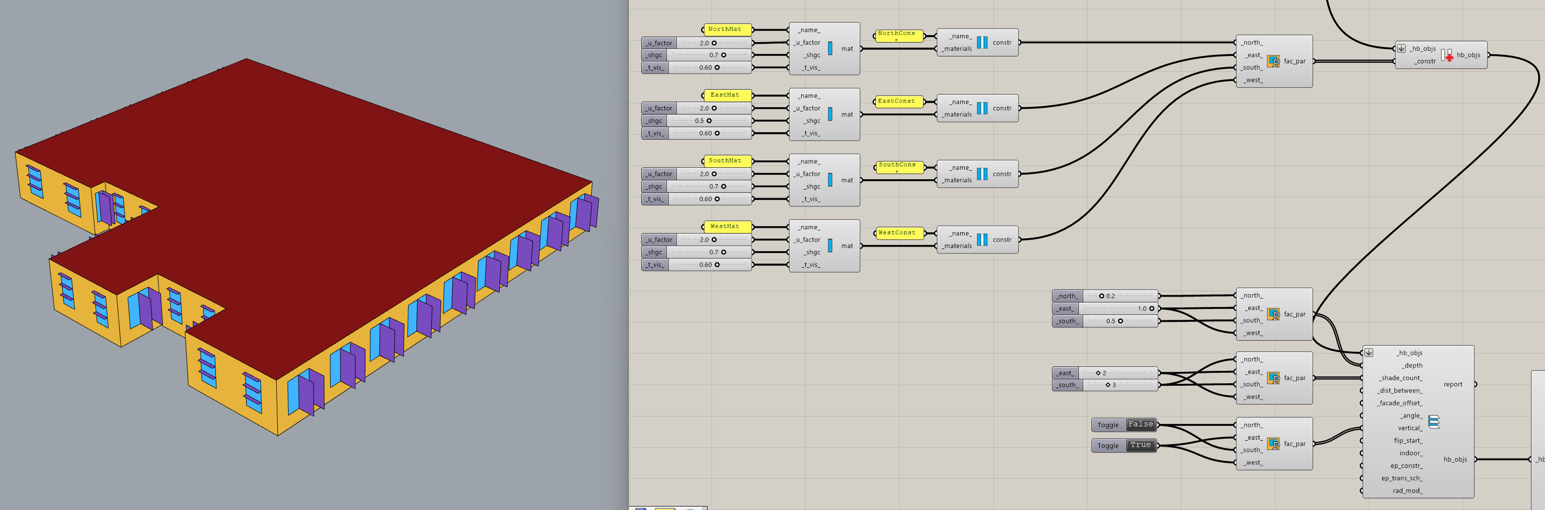

Hi @Erikbeeren ,
I suggest this approach instead of the one in the file you attached. I believe is cleaner and efficient.

Thanks a ton! Just to be clear- should I not reconnect them back in the loop so the windows with the shades are simulated as a honeybee object?
I did some cleaning but this is a messy file.You should do this yourself to be sure everything is well connected and working.
