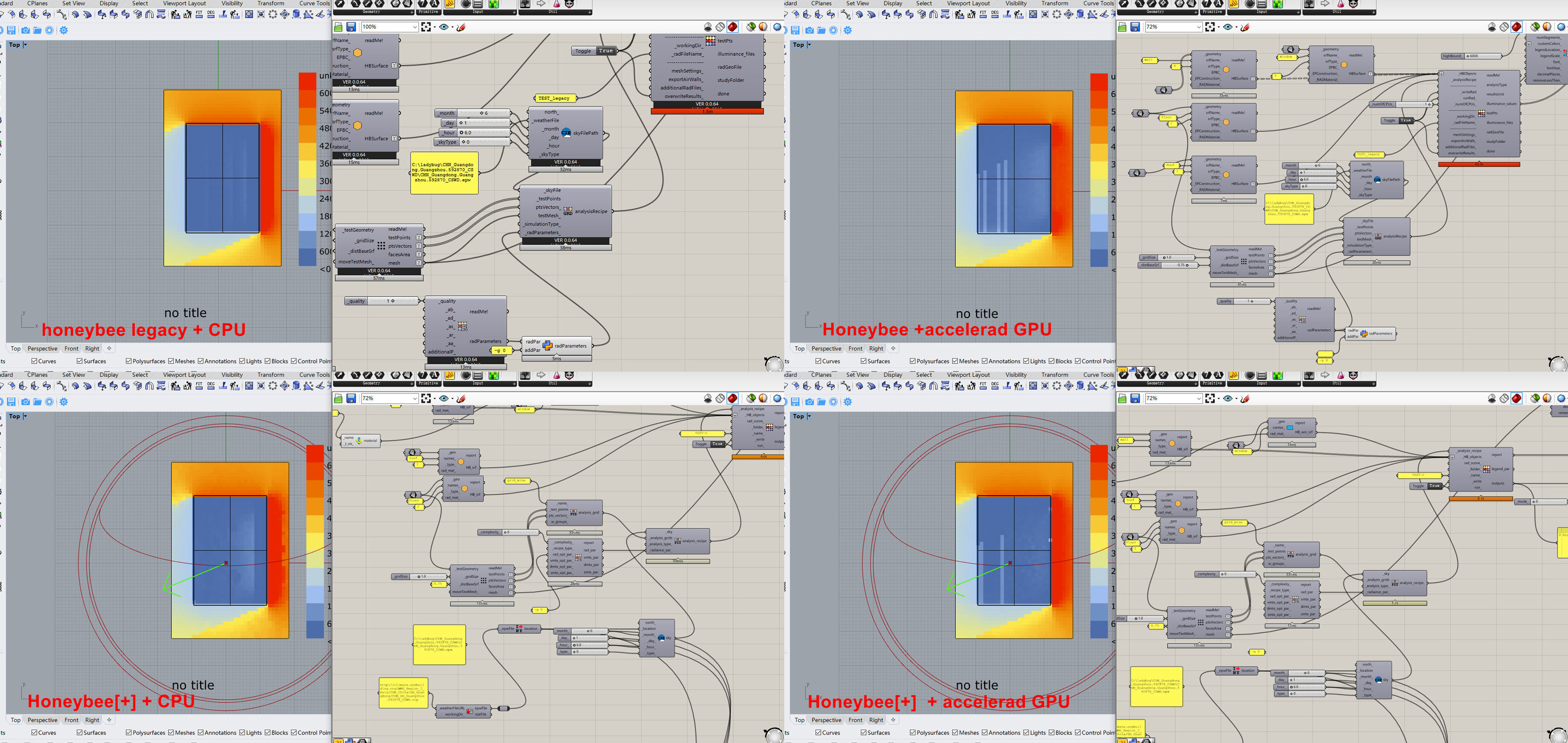

I have a comparison of the four pairs using one same simple scene to run daylight simulation, the results are as belows:
(new user can post one picture)
According to the accelerad manual, adding -g 0 argument will let the accelerad use CPU instead of GPU, I’ve also test the original rtrace.exe, the results are the same as that using the -g 0 argument. So the way I switch between GPU and CPU may be right.
First, I can’t tell why there are stright lines in the GPU simulation, I think it is not direct value because I can’t get rid of it using the cumValue component’s mode_2.
Second, in the CPU ones why the illuminated area are all on the left of a stright line, lets compare the different time 6-7-9-11-13-15-17:
And finally the third question, commpared with honeybee[+], may I conclude that the honeybee legacy is not accurate(below is the comparison of 8 am.)?

I think I’ve figure out why:
Firstly when I calculate the 8am. sunlight I saw the difference of GPU and CPU in honeybee legacy simulation (High parameter):
So I cut a hole the same place of window:
Then the results match!
The reason is now clear.I wonder had I wrongly add windows? Must I cut a hole on the wall?
