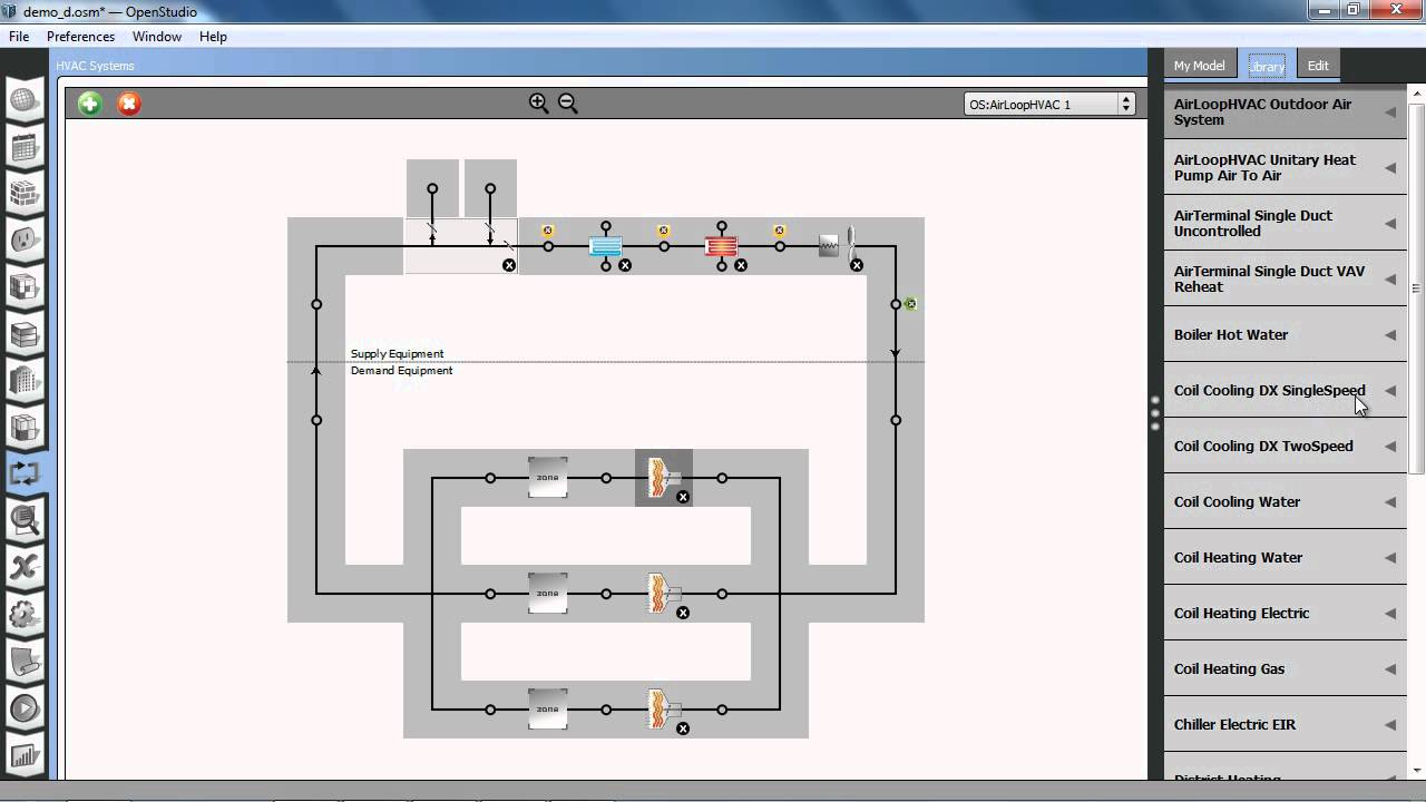

Hi @Shubhanshi ,
The Rated COP of VRF systems can be found here in the OpenStudio App:
But bear in mind that this is just the rated COP, which is much like the fuel rating of a car. That is, this is just the COP under some standard conditions and the actual performance of the unit is dictated by the outdoor conditions at a particular hour, the demand of the building, and the performance curves of the VRF unit.
NREL has produced some good tutorials that walk you through the interface of the OpenStudio App. This one is pretty good for understanding the basics of the HVAC UI:
