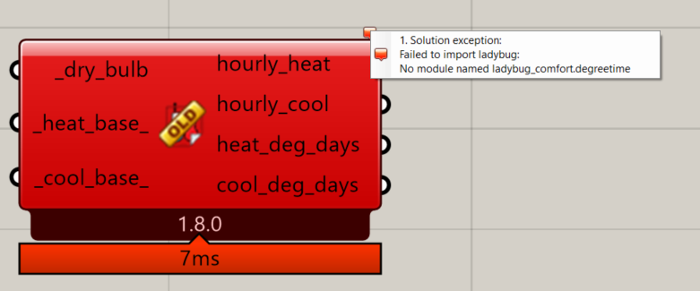

Hi Chris, I’m getting an error using Rhino 8 with LBT 1.8.0. Still shows the ā€œOLDā€ tag in the icon. Do you know what might be causing this?
what happen if you edit one of the tools, do you see these lines of code in the beginning?

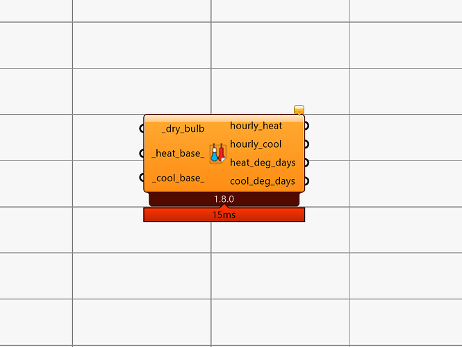

Hi tay.0,
Still getting the error. I assume you mean editing the component using ā€œOpen editorā€¦ā€

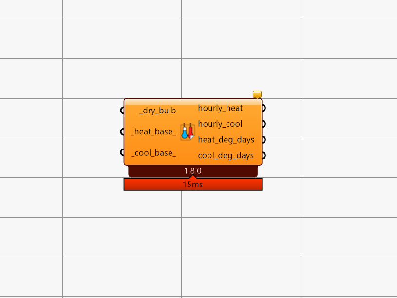

I get this message:
I still have Rhino 7 installed on my computer. Could that be relevant to this?
can you try installing the pollination plugin instead, it should come with Ladybug inside. I have a feeling that yours did not install properly.
