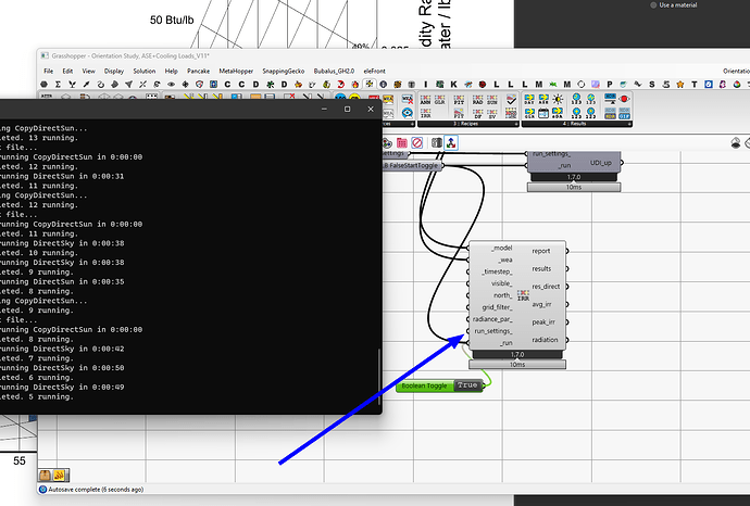

OK, I nuked my LBT install from Food4Rhino and installed with Pollination, and it seems to work in Rh7, and have located the Ladybug .rhp in ProgramData>McNeel>Rhinoceros>packages>7.0, restarted and deleted the py39-rh7 folder again, but it still gives me the same error
“1. Solution exception:Could not find a part of the path ‘E:\Grasshopper_Calculations\test8.3dm\annual_irradiance_logs_\logs.log’.”
It looks like you have a problem with the file path for the Logging, can you disconnect the run_settings_?
