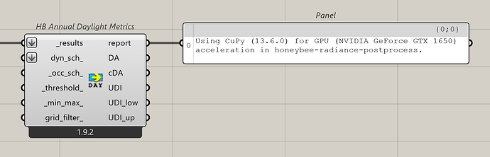

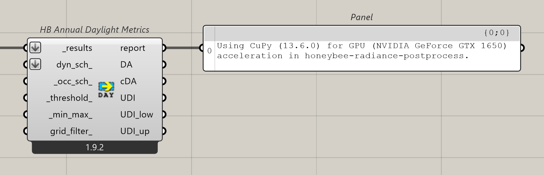

How can I tell if honeybee-radiance-process is using CuPy and not NumPy?
honeybee-radiance-postprocess will print a line that tells you if CuPy is being used. You should see something like this:
Using CuPy (13.6.0) for GPU (NVIDIA GeForce RTX 3080) acceleration in honeybee-radiance-postprocess.
In Grasshopper the post-processing components will also report this statement in the report output.
If CuPy is installed but fails during initialization honeybee-radiance-postprocess will fall back to NumPy. If this happens you should see a statement similar to this:
Failed to load CuPy successfully. Falling back to NumPy (1.26.4) in honeybee-radiance-postprocess
