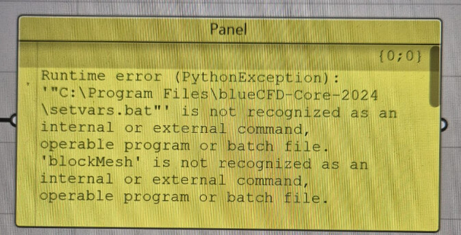

I got an error while running butterfly.
while running block mesh:“1. Solution exception:‘“C:\Program Files\blueCFD-Core-2024\setvars.bat”’ is not recognized as an internal or external command,
operable program or batch file.
‘blockMesh’ is not recognized as an internal or external command,
operable program or batch file.”
I have “C:\Program Files\blueCFD-Core-2024\blueCFD-Core_MSys2_mingw64.bat” installed.
How can i fix it?
Thank you in advance
Butterfly only use blueCFD 2017-1 verison, not lastest 2024 version
