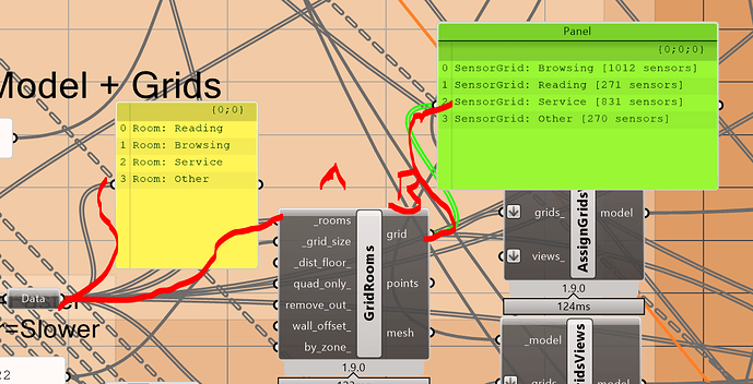

Input A is organized in a certain way, then Output B has it reorganized.
Where is that coming from ? It’s a big problem. I can officially report it, where’s the best place ?

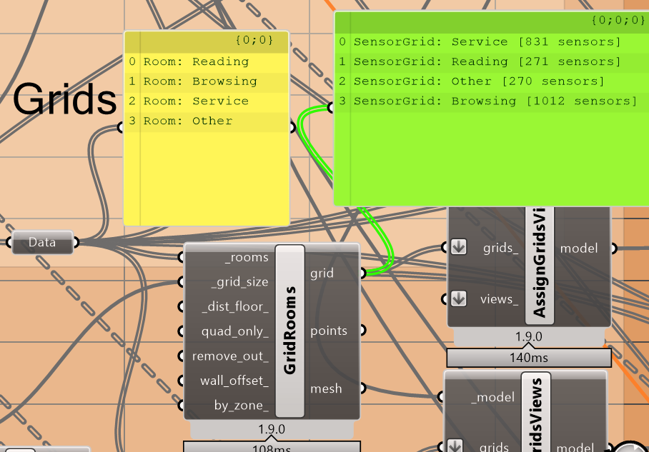

Happened again,

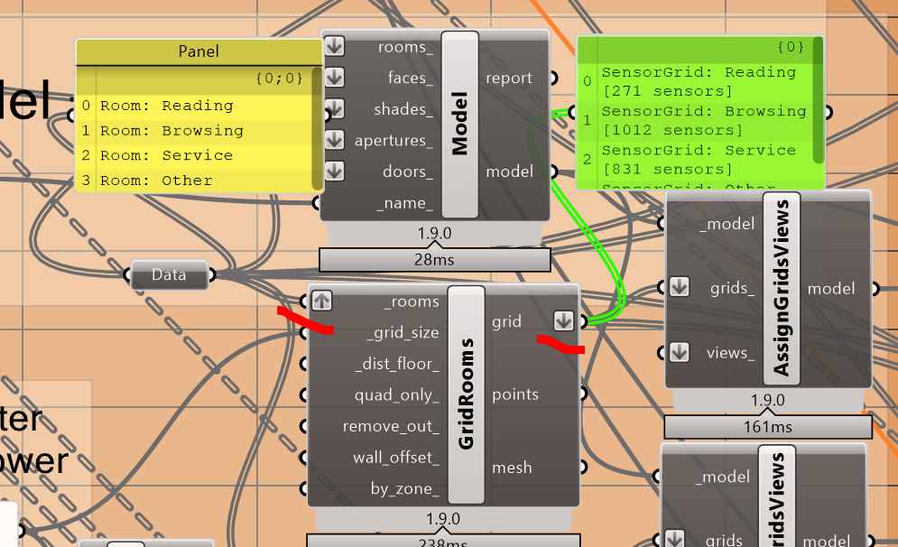

I found a workaround, but it seems to be a glitch, who agrees ?
No one else is experiencing this problem ? Just me ?

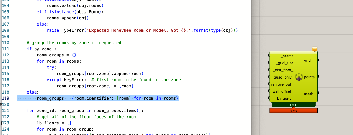

Might be? It appears that this behavior might be related to the new by_zone option?

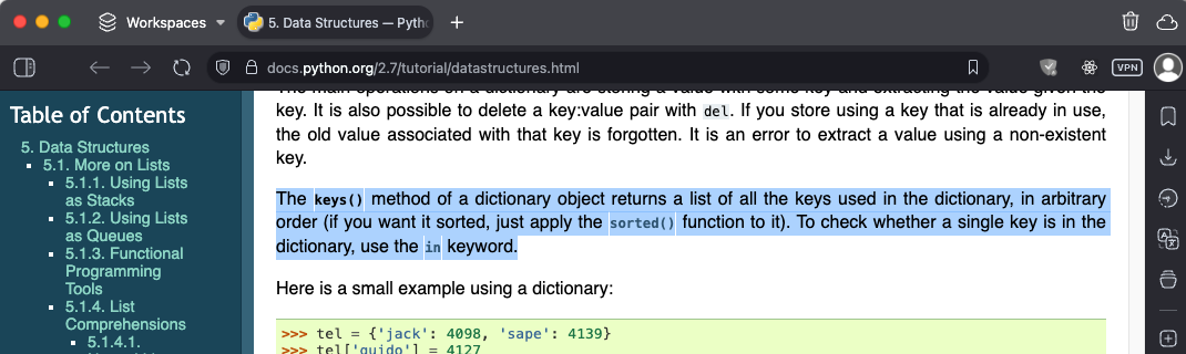

It appears like this component now iterates over a dictionary of the rooms keyed by their ‘identifier’,
which is not guaranteed to be in any specific order in python 2.x
Do the sensor grid outputs need to be in the same order of the input _rooms for your workflow? Seems like your graft hack works of for the moment?
@edpmay
It works but it will confuse users in the future. Could that be treated as a bug ? I could log an error report if necessary.

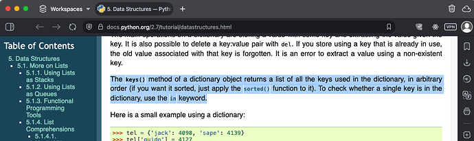

That is the correct explanation, @edpmay .
Dictionaries in Python 2 are unordered. So the order can change each time. If the change in order is bothersome, we can replace the use of the native Python dictionary with an OrderedDict object from the collections module. You’ll find that some of the other components do this. Here is an example:
