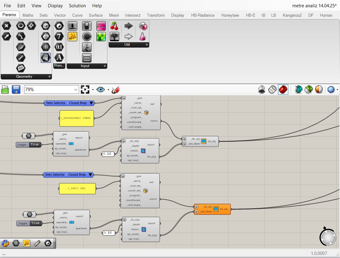

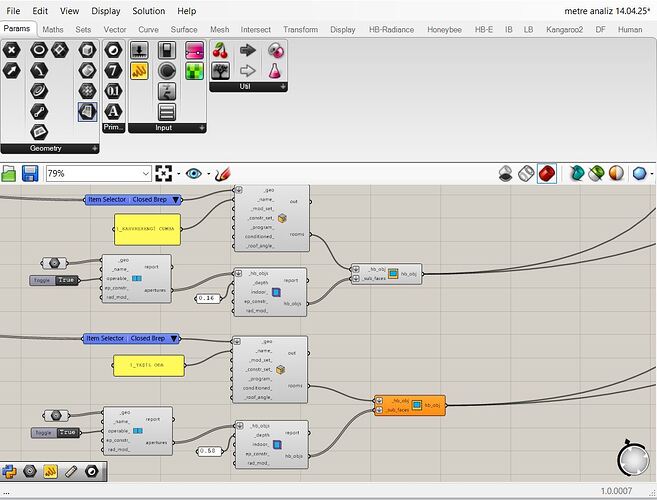

I am doing a thermal comfort analysis of a house. I defined the rooms of the house with a separate closed brep. However, for some rooms I get a warning like this in HB Add Subface. (1. The following sub-faces were not matched with any parent Face: Aperture_8b0cd04b, Aperture_69f532b9).
How can I solve this?
I would be very happy if you could help me.
Make sure all of your aperture geometry is coplanar and fully bounded by the parent Faces of the Room.
