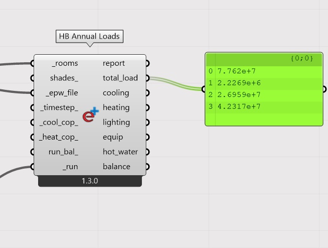

Hello everyone,
I don’t know why the total load results of the HB Annual Loads are multiplied by e+7 or e+6.
It think the right value should have been 77.62, etc.
Hello everyone,
Hi @yasaman_namazi,
Probably the units of your Rhino drawing are set to mm or cm.
For energy simulation theay have to be set to meters.
Yes, that worked!
Thank you.
