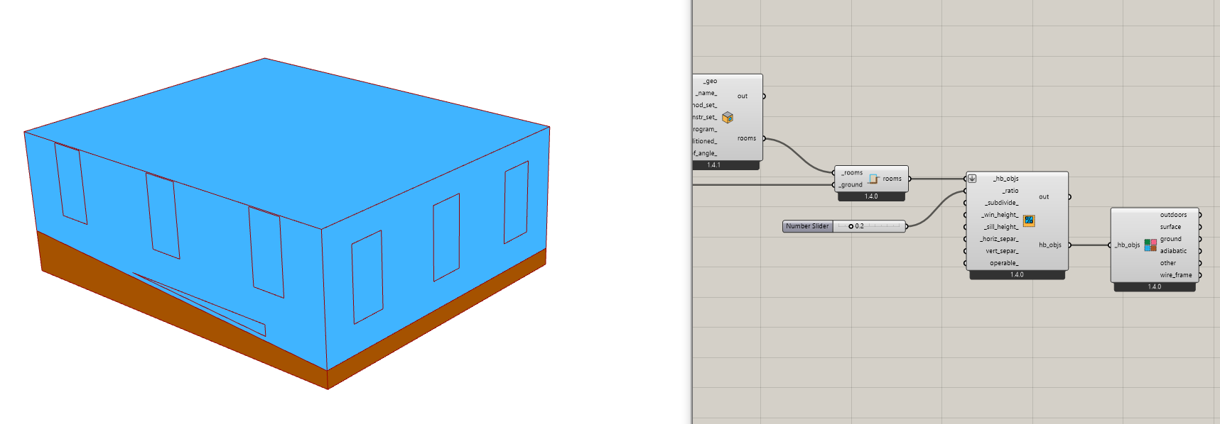

I was just testing some new workflows. When using Custom ground and splitting wall surfaces into ground walls and walls, the aparture by ratio is not working correctly.

Yes, there were a few bugs like this in the “Apertures by Ratio” workflow in the last stable release. They have since been fixed in the latest development version of the plugin.
So just run the LB Versioner and restart Rhino. Then, you’ll see that everything works as expected:
