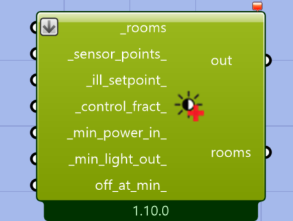

HB Apply Daylight Control
With the current workflow of HB Apply Daylight Control- The current daylight control type uses a continuous option OR a complete turn on/turn off option.
@chris If there is a stepped daylight control option available, could you please provide the workflow/component for the same! Thanks in advance!
