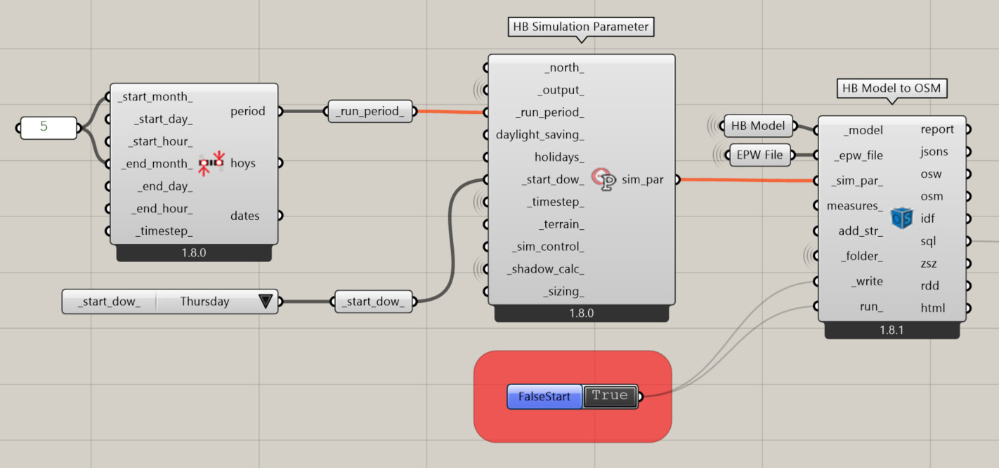

When setting both run_period and start_dow in the HB Simulation Parameter, the latter isn’t written correctly into the IDF. It seems Honeybee assumes the Start Day refers to January, picks a reference year that matches that condition, and then shifts the Start Day based on that year. But EnergyPlus wants the Start Day of the selected Run Period, not of the year.

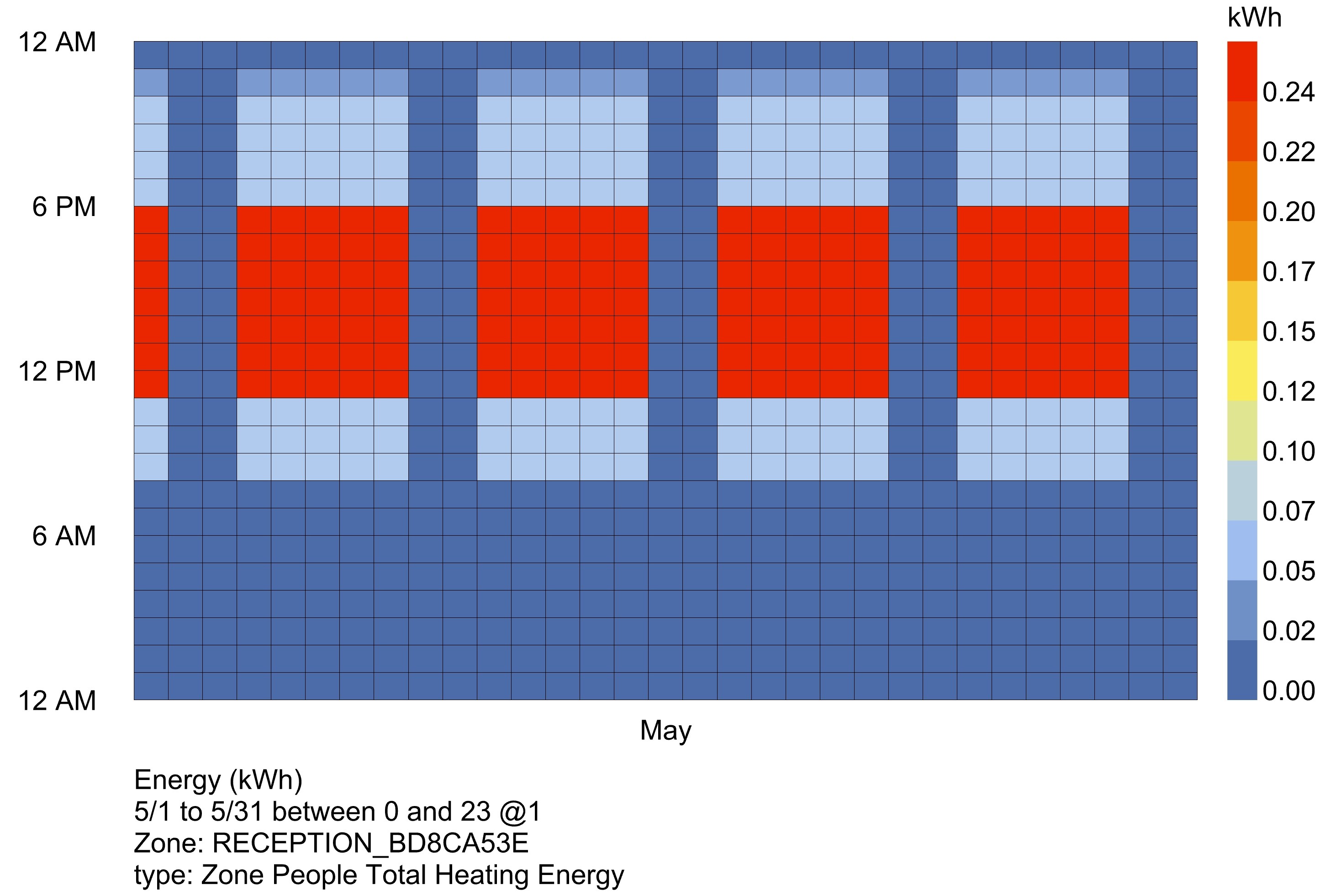

For example here I chose May as Run Period and Thursday as Start Day (as in 2025). In the IDF I get year 2009 and Start Day = Friday, because 1 May 2009 was a Friday (and 1 January 2009 was a Thursday). The simulation confirms the issue: it starts on Friday (occupied) then weekend (unoccupied), rather than starting on the Thursday.

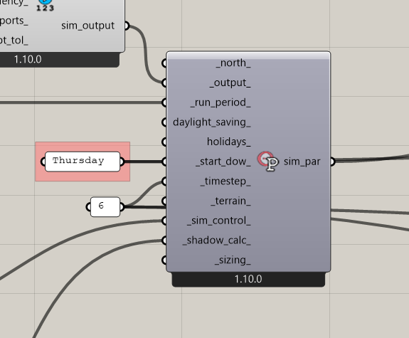

I just wanted to flag that EnergyPlus v25.1 seems to handle the run period differently than in previous versions.
Whereas previously the start_dow input in the HB simulation parameters would set the start day of the simulation, the most important parameter now appears to be the year. See the following warning message in the error file :
Warning RunPeriod: object=RUN PERIOD 1, start weekday (THURSDAY) does not match the start year (2006), corrected to SUNDAY.
As a result, the start day specified in the sim_par component is no longer written to the IDF. Even if it is manually changed in the IDF, EnergyPlus will override it based on the selected year.

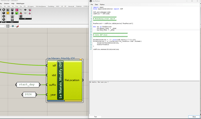

I recommend explicitly controlling the RunPeriod via an eppy script to assign the desired simulation year. The start day will then be automatically adjusted.

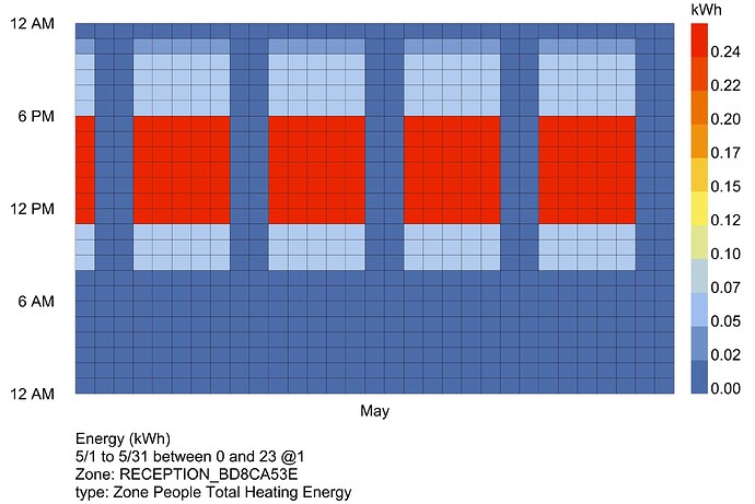

I tested and this seems to produce the expected behavior in the E+ simulation.

We’ve tried running it both with and without a run period and it seems to work perfectly.
