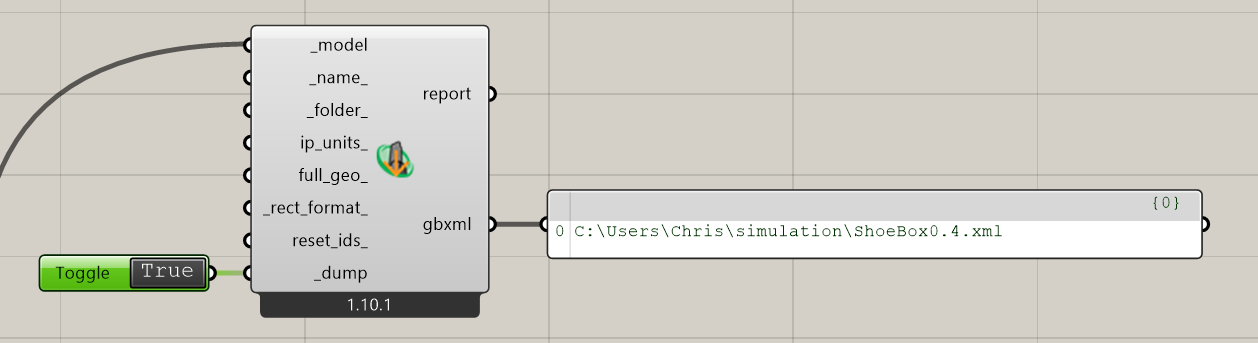

Hey @mchabasset ,
Thanks for letting us know but the HB Dump gbXML component was recently rewritten to no longer have a dependency on the OpenStudio SDK, which probably solves this issue. Can you run the LB Versioner and make sure that you are using version 1.10.1 of the component?
You’ll know that you’re using the new component if you see a new option to get the gbXML in IP units.
Also a note about this:
I think our new native Python gbXML exporter should be able to handle all of these characters in the names without issues. Let me know if you find otherwise.
