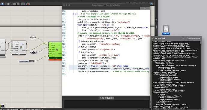

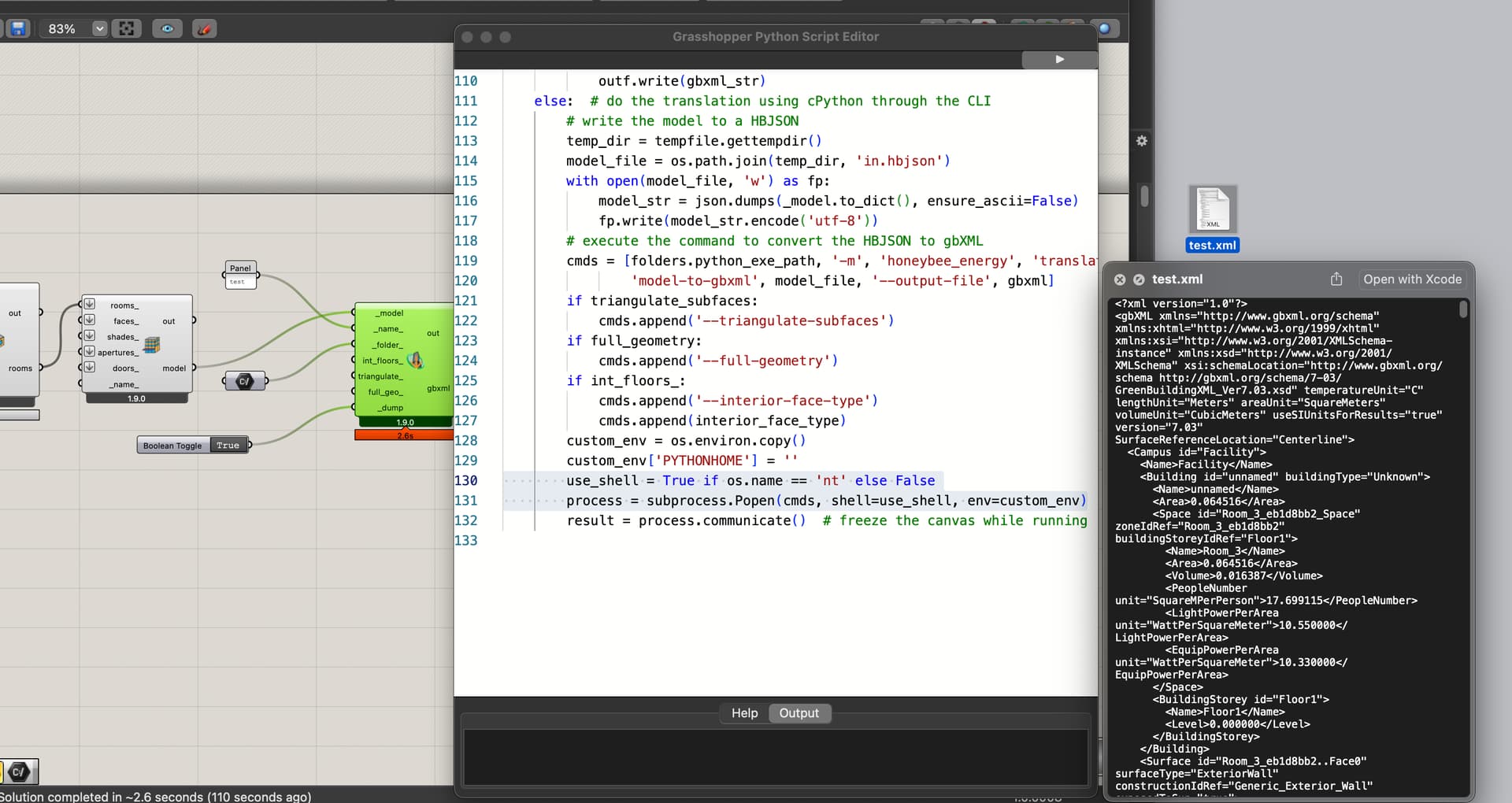

@chris : I think the error is that the component’s Popen call has the argument shell=True, but on MacOS that should be False. Specifically, if you change line 130 from:
process = subprocess.Popen(cmds, shell=True, env=custom_env)
to:
use_shell = True if os.name == 'nt' else False
process = subprocess.Popen(cmds, shell=use_shell, env=custom_env)
it will then work correctly:
