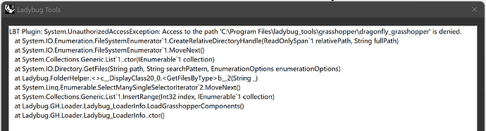

Hi Mikkel,
After using the versioner to update, when loading grasshopper, this happens:
All my Ladybug components are missing. Let me know if you know a fix to this?
