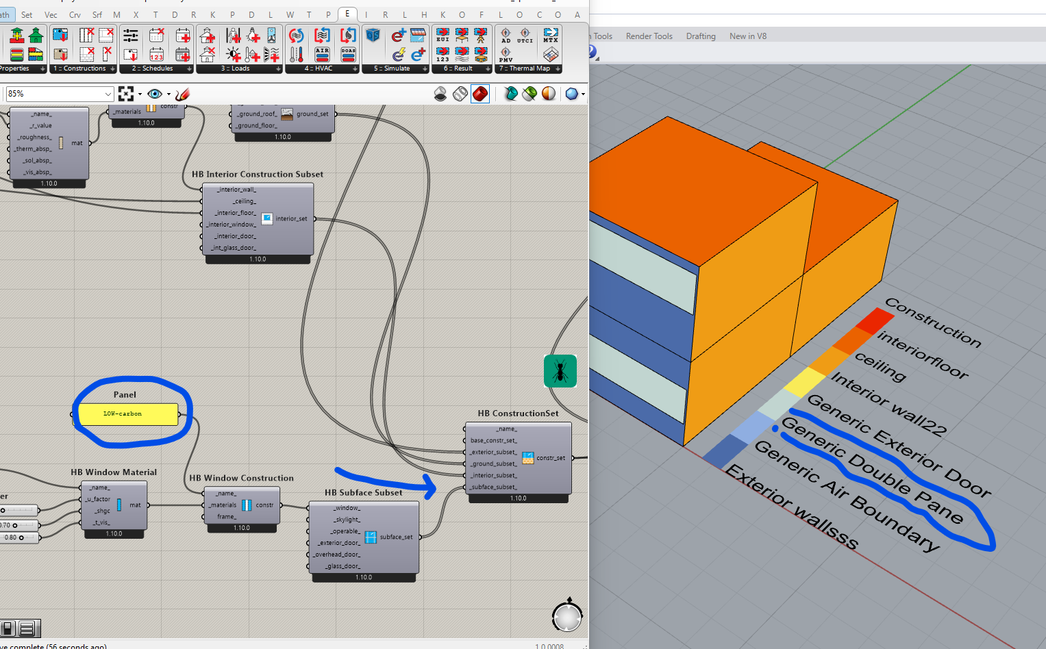

Hi @chris
changing the materials of window by HB subset through HB Const Set is not possible.
However i can change them by HB apply window constr only.
Hi @chris

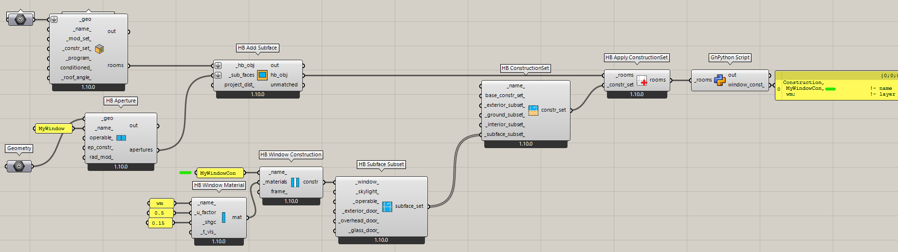

Hi @Aliarch I’m not able to replicate the issue, could you share more of your script?
ap = _rooms.apertures
window_const_ = ap[0].properties.energy.construction
best,
Hi @TrevorFedyna thank you
after updating, it is working fine. thanks
