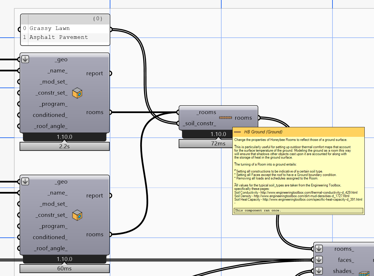

I found myself within this situation last week and I decided its “more elegant” to make a room out of the ground (as proposed in the “comfort under a tree” sample) rather than the dummy room!. Hope this was useful.
