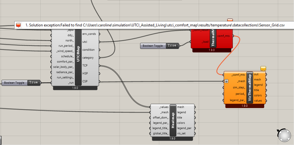

I am having issues with the UTCI comfort map component. I cannot visualize it since it is not creating any CSV files only NPY files. The read thermal matrix will not run beacuse there is no CSV file.
I hope someone can help ![]()

Hey Caroline, I have the same problem and can not fix it either. Did you find the solution?

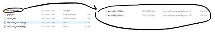

How does the folder (the folder in the utci output) structure look like? It should look something like this.

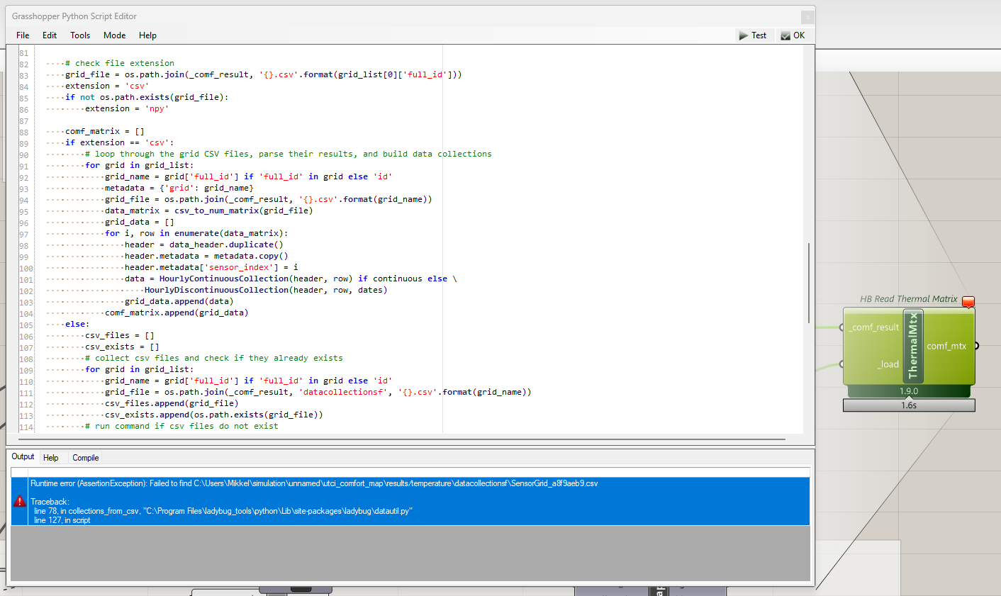

Also, can you double click the component and then run it? This should print the error in the bottom of the new window as well as the line where it fails. This will help with debugging the issue.
