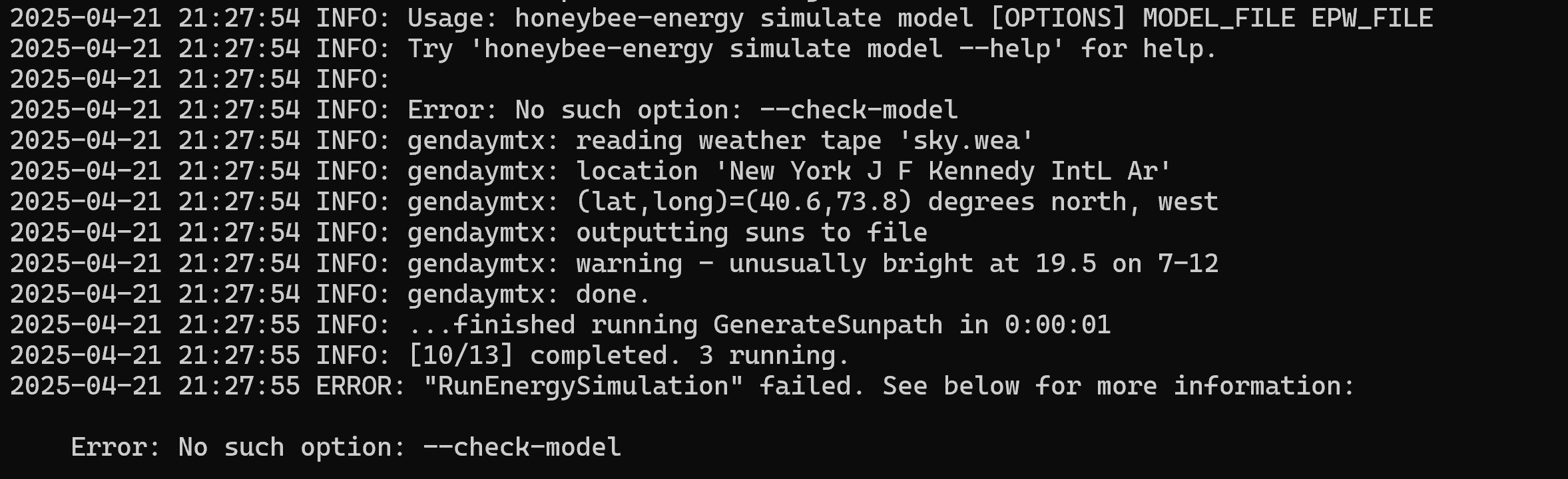

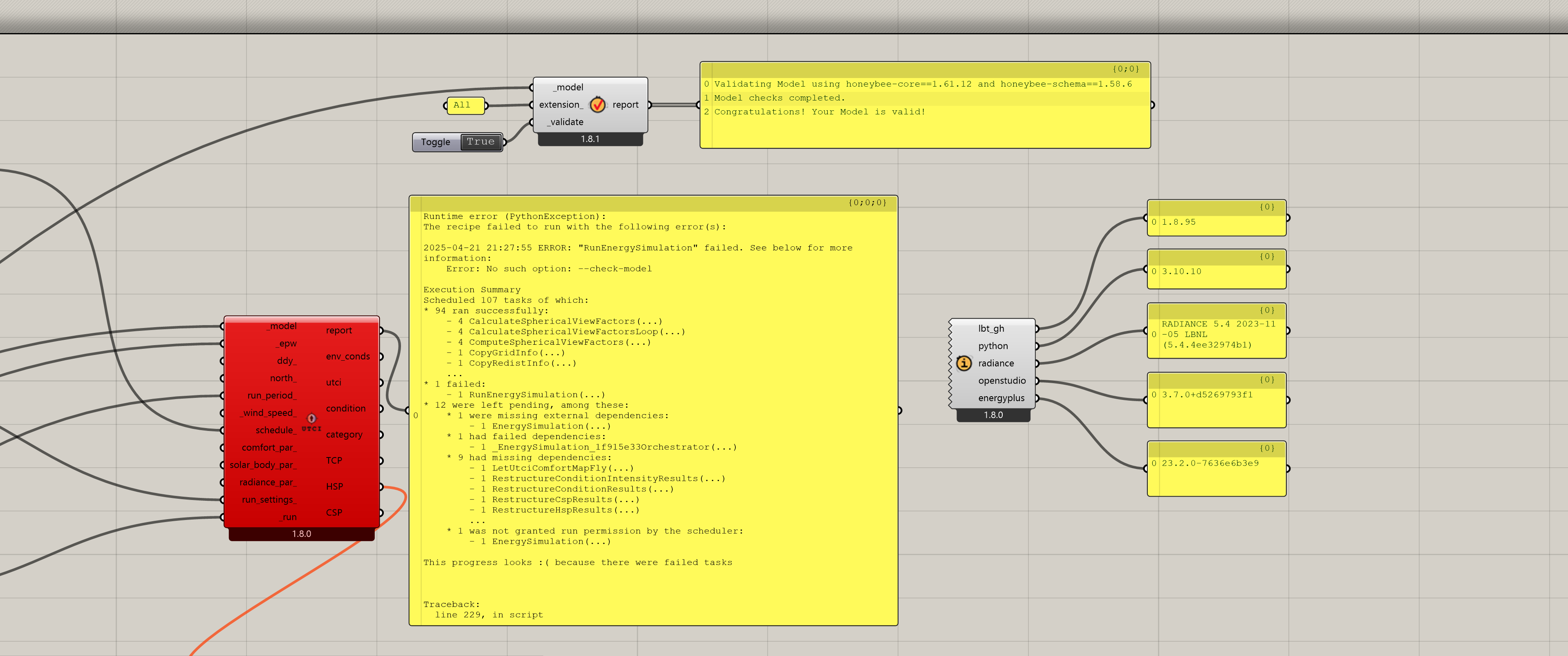

I have an issue regarding the HB UTCI component, and I have tried to find solutions in the forum but to no avail. I did the following things:
- Reinstalled the plugin with the pollination grasshopper one-click installer as suggested by Chris.
- Ran the UTCI comfort under tree sample ghx to check if the issue is on my (newbie) script
. - Checked whether any part of the installation is faulty by running other HB sample scripts - but looks like everything else works fine. I initially thought the issue was with the OpenStudio 3.7.0 installation.
When running the HB UTCI script - the command prompt showed this line:
Error status and version validation:
Logs - HB UTCI_Logs_Error.zip (27.4 KB)
Grasshopper script - Script_Error.gh (165.8 KB)
I hope the information I provided helps. It would matter very much for any help and suggestion ![]()
