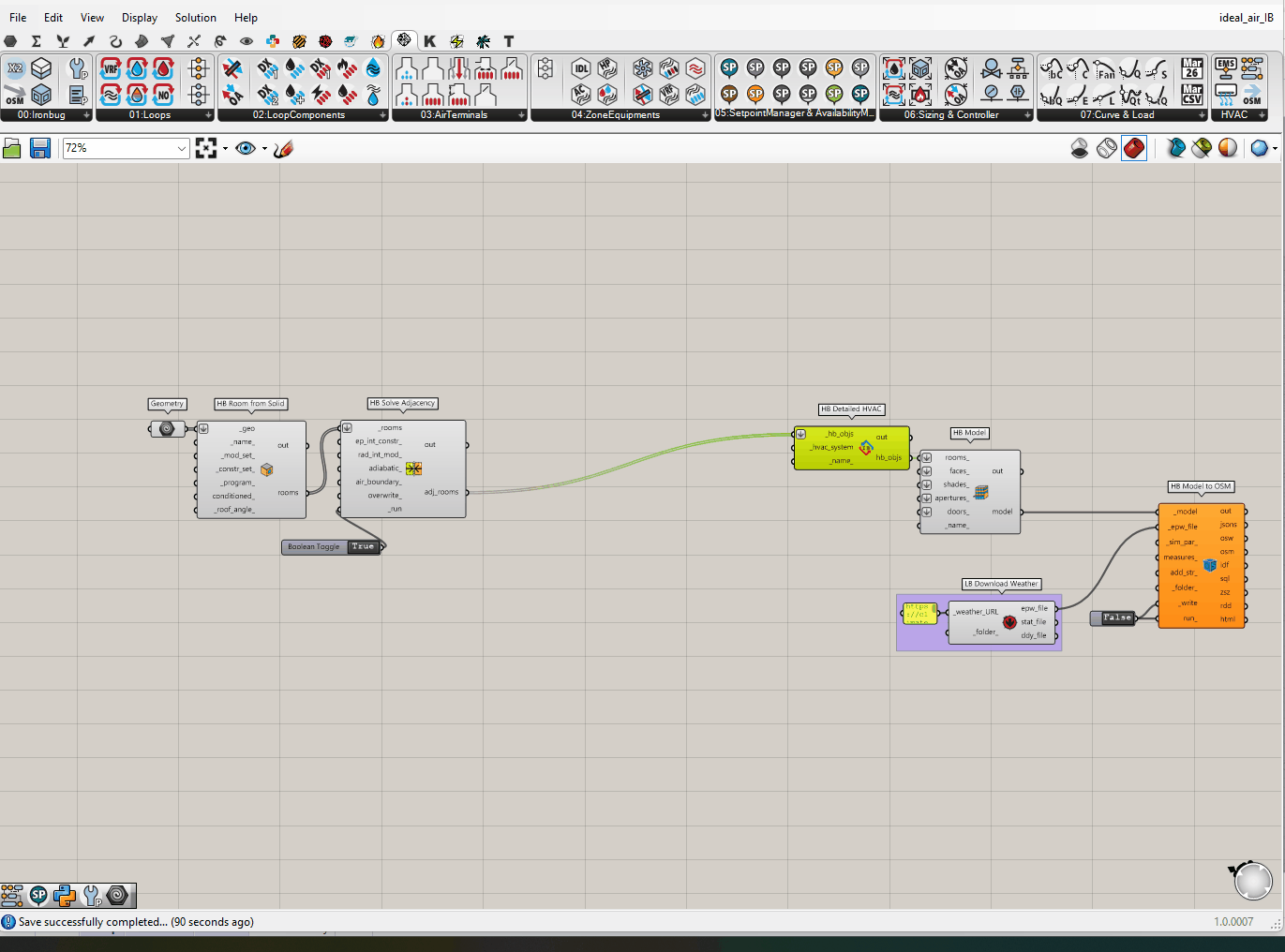

Hi @marctavenier, I donât know the cause of the issue you are having but here is a quick workaround with ironbugâs ideal air template:
with the corresponding file attached below:
ideal_air_IB.gh (51.6 KB)
The file does run.
Hi Trevor,
Thanks for your reply. That seems like a good workaround indeed until the bug is fixed.
