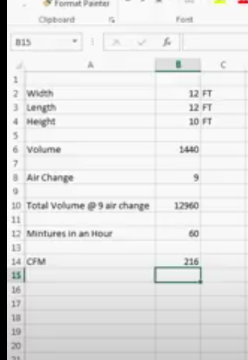

Is there a plugin in GH that can calculate the air changes/hr or use the formula to do the conversion…can anyone tell me if you know?

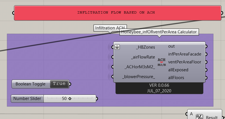

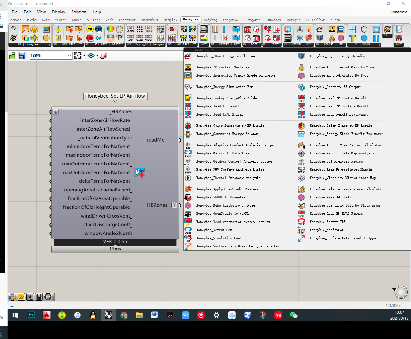

Hello, I have tried this component.

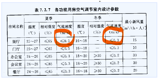

Is the parameter of “Air Flow Rate” in it from the architectural design standard?
For example, if indoor ventilation is set at least 2 times per hour, is that the option corresponding to the above “air flow rate”?Or does it correspond to wind speed m/s?
