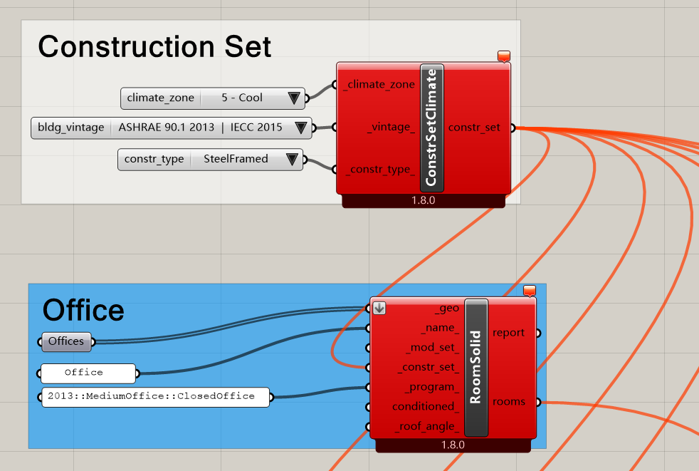

HELP!Failed to import honeybee_energy:
  1. Solution exception:
    No module named honeybee_energy.lib.programtypes
Why do these batteries all report errors?
This is an installation issue. Try to install the Grasshopper plugin using the Pollination single installer that also installs all the dependencies.
