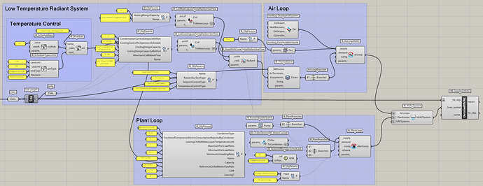

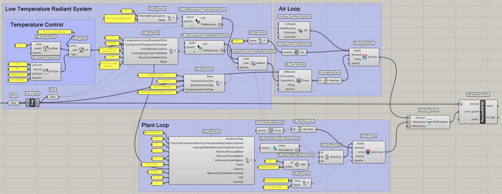

I’m currently working on energy simulation for a low-temperature radiant panel system. However, I encountered a puzzling issue:
Whether I enable or disable the radiant system, the overall energy use intensity (EUI) changes very little. The HVAC components report no errors and the simulation runs successfully, producing energy data — but it seems like the radiant system is not actually affecting the results as expected. I tried to change the CoolingControlTemperatureSchedule, but the result remain the same.
As a beginner to Ironbug, I suspect there might be issues with the component connections or parameter settings in my GH definition that prevent the system from functioning properly.
I cannot upload my GH file, because I am a new user. But if necessary, I could send it by email. I would greatly appreciate if anyone could review my component connections and parameter setups, and provide any insights or suggestions on what might be going wrong.
