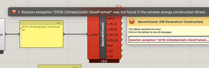

Hello!
Hoping someone can help me figure out why I am experiencing this error. I thought I had all of the plug ins installed correctly, but from what I’m seeing something seems to be missing.
I’m not super great at the set up of this, so it would be great if someone could walk me through what I need to do.
Thanks!
Hi @amfensch there is a pollination grasshopper standalone installer that does everything so you don’t have to. If you installed via the rood4rhino installer I’d try the pollination installer and see if the issue persists.
