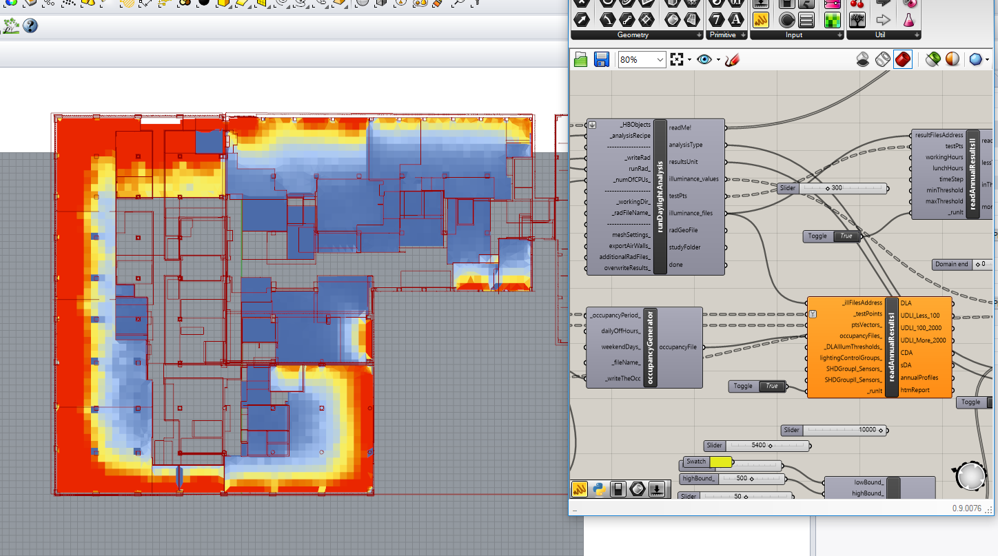

I am trying to read annual daylight result from daylight analysis but some how I get this error and even by changing the number of cpu I do not see any difference.
It seems like I cannot upload anything but here is a link to the model and grasshopper script.
The component you are using to read results is for the annual simulations. For a grid based simulation that you have, you only need Ladybug recreate mesh component.
Oh I see. I change the analysis receipt to annual I get this error: “1. Solution exception:‘Brep’ object has no attribute ‘split’”. It was working for Grid Base Simulation.

I am not able to zoom into the image you shared but it looks like instead of a honeybee object, a grasshopper brep is being supplied to the honeybee component.
Grasshopper Brep = Geometry
Honeybee Brep = geometry + information
Hi Devang thank you for your response. I use create honeybeesurface to create my honeybee objects and then using brep component I just connect and join all my honeybeesurfaces in one component and then feed it into the analysis component. Is that wrong?
