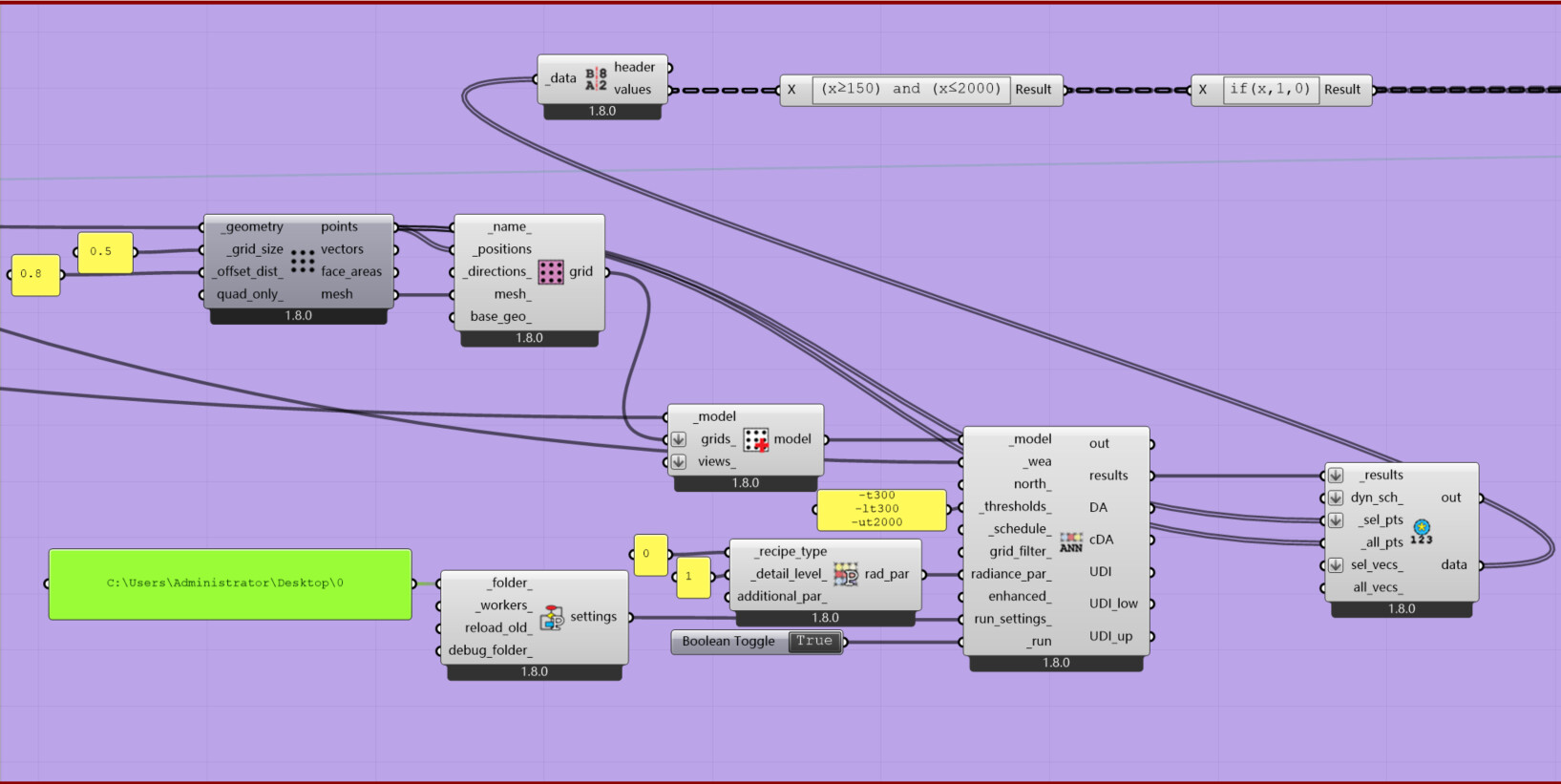

Thank you for your reply. Figure 1 is my daylighting calculation module, and my purpose is to screen out the time when at least 60% of the room meets UDI needs throughout the year. My model calculates fine and can get results.
My problem is that the current Annual Daylight simulation is too slow, and even if I use a server with 100+ threads & a lot of memory, it still can’t effectively improve the speed of the calculation. I think it’s because parallel computing is not implemented, but I do set a reasonable number of workers in the HB Recipe Settings(The number of wokers is not set in the figure because the maximum number of CPUs minus 1 is chosen as the default). The Task Manager showed that only one or two CPUs were in high usage, which confirmed my suspicion.

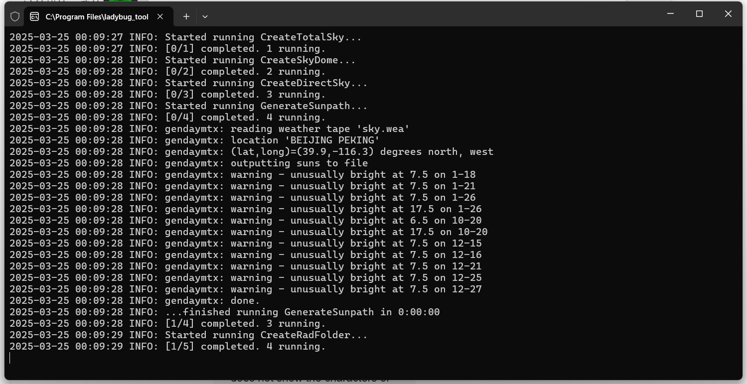

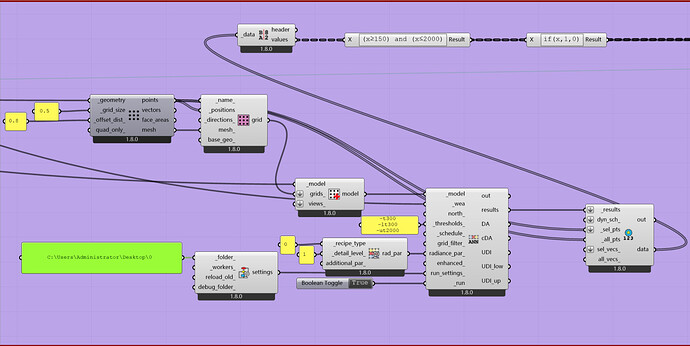

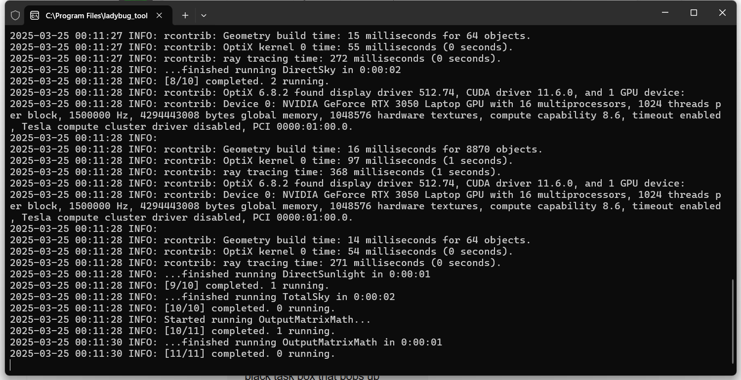

Using Accerarad is a way I’ve seen accelerated computing. However, when I re-calculate in Honeybee after installation, the black task box that pops up does not show the characters of Accelerad, as far as I know, this does not happen when you successfully use the tool to calculate. Figure 2 and 3 are screenshots of my command prompt, I see the characters ‘GPU’ appear in Figure 3 but don’t understand if this is related to Accelerad.

Your third figure shows the output of Accelerad, indicating that Accelerad is running and there are no errors reported. In other words, it appears that it is working as expected.
When you use Accelerad, you should use only one worker. This is because GPUs do not support having multiple workers, so trying to access the GPU by multiple workers slows the entire process down.
If you are comparing Accelerad on a single GPU to running 100+ CPU workers on a computer that has 100+ CPUs, I do not expect that Accelerad will give you a significant speedup in that case.
