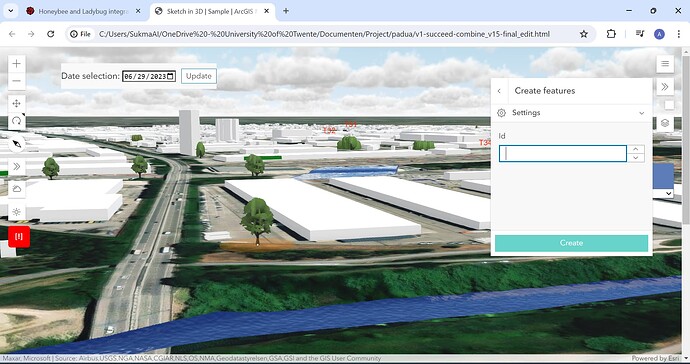

I am im the development phase of web gis for stakeholder participatory that enable the users to create their own nature-based simulation scenario. My web app mainly using esri web api, but due to the limitation of esri that can not go to such a building component detail, I am looking for another possible integration for my web app. I knew that honeybee fits my need, but I am not sure such an integration with esri is possible. May I know, if anyone might understand about this or any experience about this, whether it is possible to create such an integration? Because I know esri products are somehow totally restricted to have any integration, but i also succeeded to develop IoT integration on backend for this web app.

Thank you for your response. The idea of my work is to provide the direct feedback of the effect from the NBS plan of physical temperature equivalent (PET) model , for this case the type of NBS are: tree, water body, grass, and green facade. The web app that i developed serves as the participatory tool that enable the stakeholder to create the urban plan of NBS (I attach the picture of it).
