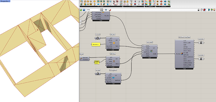

Why is it that after I set up the interior walls and doors and windows with HB Model, the interior walls don’t automatically open holes based on the location of the doors and windows. Attached is my file. Thank you very much for your answer!
honeybee.gh (59.5 KB)
I suggest to review your modeling strategies. You are trying to define various rooms via faces. This is not bad in principle, but the way you are doing it is incorrect. For your case i suggest modeling the rooms using boxes and solve the adjacencies between them. Just after that add the windows and doors to the room and not to the model, as you are doing now. You can find examples of doing so in the LBT provided examples (food4rhino).
