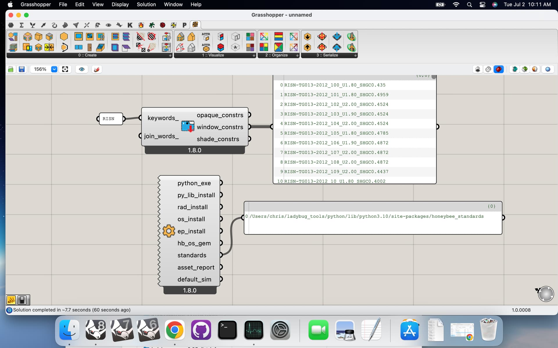

Hey @AbrahamYezioro and @tanyas ,
I just ran a test on my wife’s old MacBook and it’s all working well for me:
I am using this JSON file of some constructions to test but it should work just as well for IDF files:
RISN-TG013-2012.json (115.2 KB)
However, in both cases, the IDF file or JSON file has to either be following IDF or HBJSON schema correctly in order to be loaded. So maybe you should check the file contents to be sure this is all correct.
Also, I realize that the location of the standards library is a little odd on Mac but, if you put the files in the location that the HB Config component tells you, things should work.

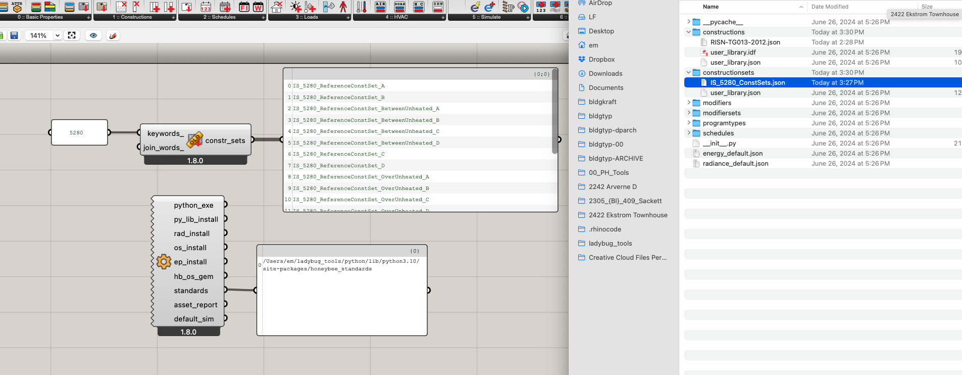

I’m providing the JSON files for the libraries we use. They work well for all students using windows. But just in case do you mind checking this file (construction set) and see if it works for you? The keyword to search is IS_5280.
Thanks,
IS_5280_ConstSets.json (874.5 KB)
FWIW, on my Mac, when this file is in the constructionset folder, it all appears to load as expected:

it eventually worked after i did a number of things, so not really sure what worked. I logged off , and when i logged back on then I saw the libraries .
tanya

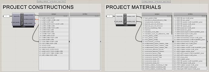

Hi

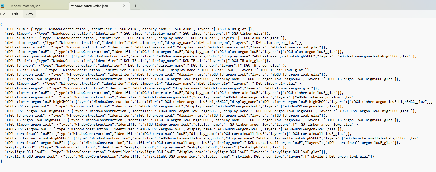

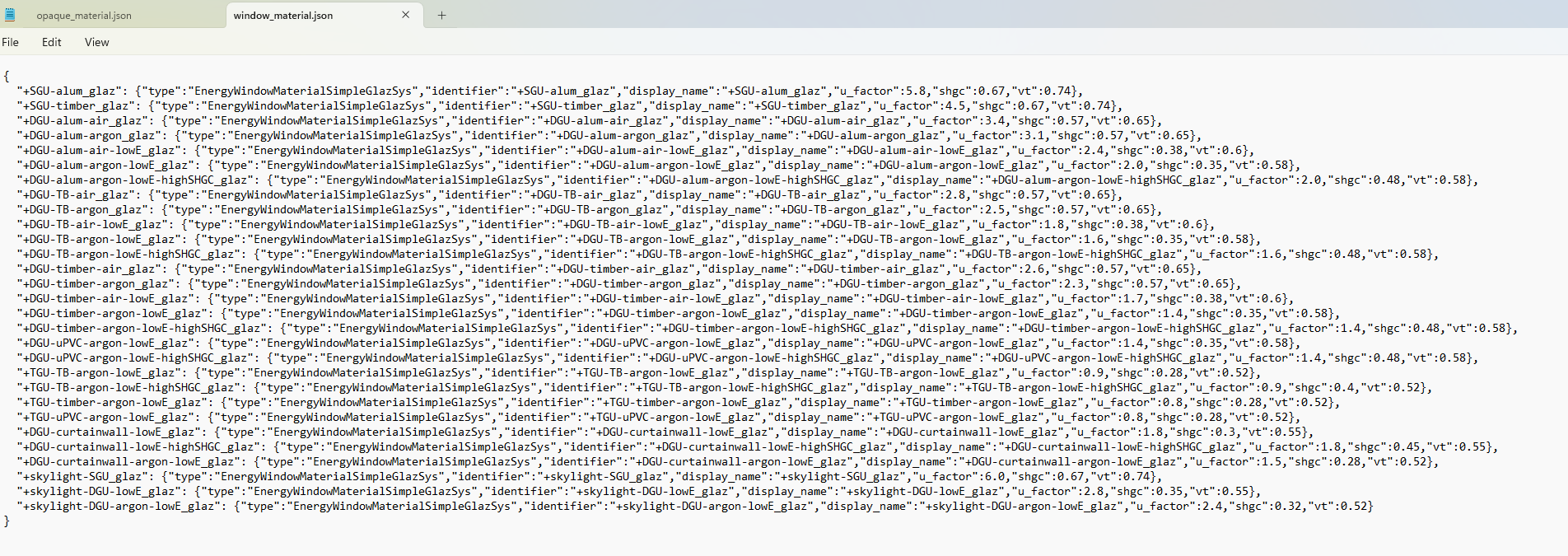

I’ve developed my own set of materials and constructions and am attempting to load these from the constructions directory as per above conversation.
Grasshopper loads the opaque materials and constructions, and the window materials but not the window constructions ??
I think I’ve got the file format correct … but
Can someone please do a quick check for me … thanks !
Crispin
Sorry - two posts as I can only embed one image per post…
Loaded constructions / materials
