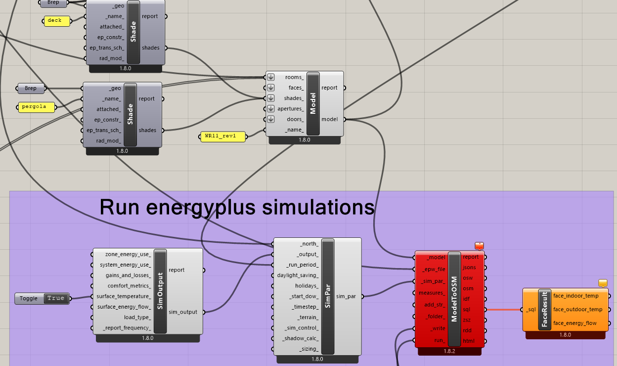

I have a Honeybee model connected to a HB Model to OSM component.
The model is previewing correctly in Rhino as far as I can tell.
When I try to run it, I get the following error.
  1. Solution exception:
    Failed to import honeybee_energy:
    Cannot import name to_openstudio_sim_folder
A screenshot is shown below.
I have used the Pollination installer for the full installation and I have also run the HB Validate Model with no issues.
Any assistance will be appreciated.
Solved. I used the v1.8.2 component instead of v 1.8.0. Needed to revert to v1.8.
