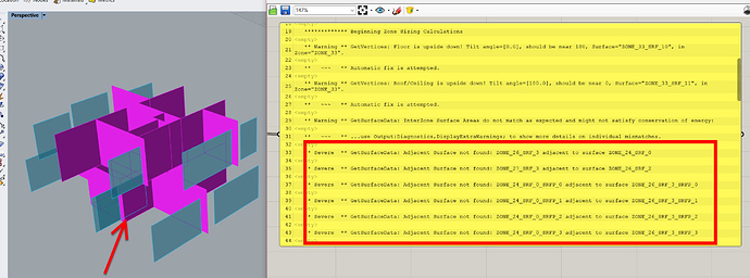

Thanks for your reply! I am a new user so I can’t upload files just yet. I have tried to run it again and it looks like it is because of the convexity issue. I have read a few posts about this in the forum, but I can not figure out how to solve to yet.
It would be great if you could please point me in the right direction.
I’m pretty sure the problems have to do with the original Rhino geometry.

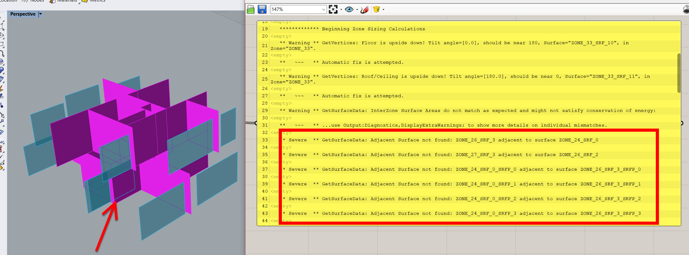

The solveAdjacencies don’t succeed with all adjacencies and then you get weird situations like those in the figure below (Internal and external wall at the same place, internal windows, etc).
I suggest to check carefully the model and be sure to guarantee the proper surfaces are coplanar.
Pay attention to the errors you get from E+. It clearly states which surfaces are not fitting.
Also set the tolerance in Rhino in a way that the adjacencies can be solved properly (i.e. 0.001).

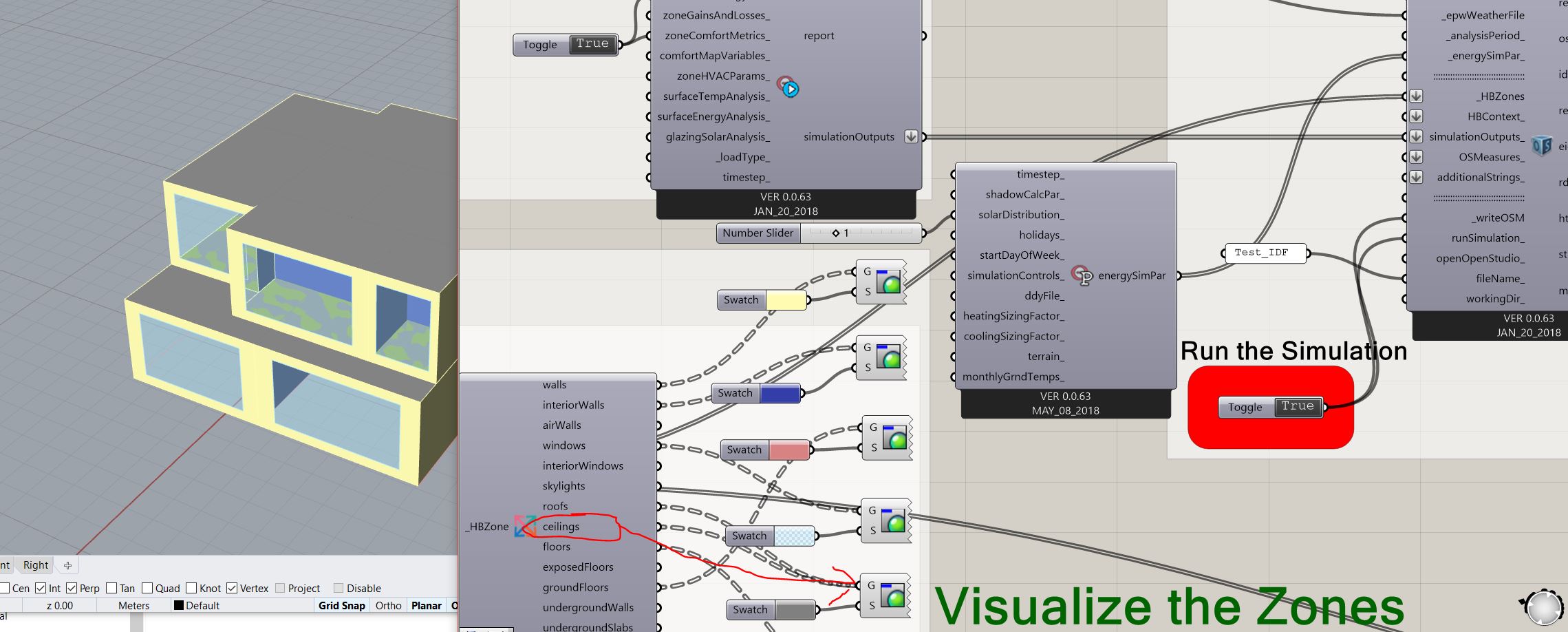

Thank you so much for your detailed response! I have been making progress, at least now is simulating something…although it looks like still not perfect. I imagine is still about the geometry, as the roofs between the 2 floors do not appear to be formed - and I don’t know how to resolve to…tearing my hair…now it says “problem in interior solar distribution calculation”…
Here below I attach the file and some screenshots, in case you can give me a hand. Thank you so much again and happy Saturday! I have booked for the workshop in Copenhagen, so hopefully I will soon become less useless…
It is indeed about geometry @Ruxandra.
About the roofs, the issue is that the missing surfaces in your image above were defined as ceilings. If you connect the output ceilings to the preview component you’ll see them.
As for the Solar Distribution Calculation, there are plenty of treads in the forum.
One of the ways to deal with it is askung for a lower resolution calculation using the EnergySimulationPar component. You can fugure it from the image below. Then the simulation runs without any severe errors.
