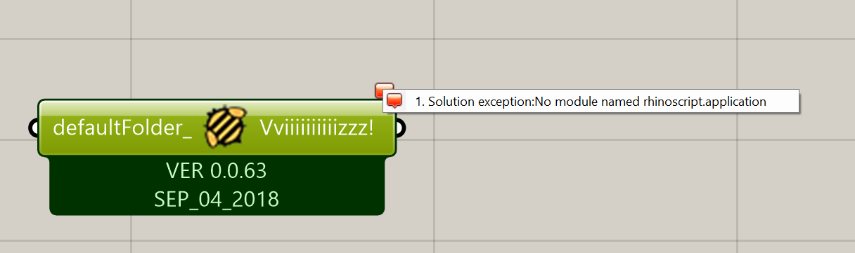

I just installed Rhino 6 and I am trying to use Honeybee but I get this error: ‘Solution exception:No module named rhinoscript.application’.

@M.Gkaintatzi ,
What component is giving you this error? Can you post a picture or an example file?
Also, what service release of Rhino 6 are you using?

It’s the basic Honeybee_Honeybee component.

The error is due to missing the application.py files, it’s weird that your installation is missing these files…
c:\Users\ %username% \AppData\Roaming\McNeel\Rhinoceros\6.0\Plug-ins\IronPython\settings\lib\rhinoscript\
You can copy them from the 5.0 script library, haven’t compared them indepth yet but so far the only difference I see is the docstring.
@vhoang that was it! Thank you very much!!
