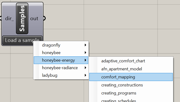

Kia ora folks
I am having the same error as reported here, but this time with the Sample File provided to illustrate this process.
The sample file, unaltered, comes from here:
There are clearly no .csv files of the temperature in the expected folder.
I am wondering whether the issue is the directory designation for the “temperature” folder: \ instead of /
C:\Users\Micha\simulation\sample_model_grid\pmv_comfort_map\results/temperature
